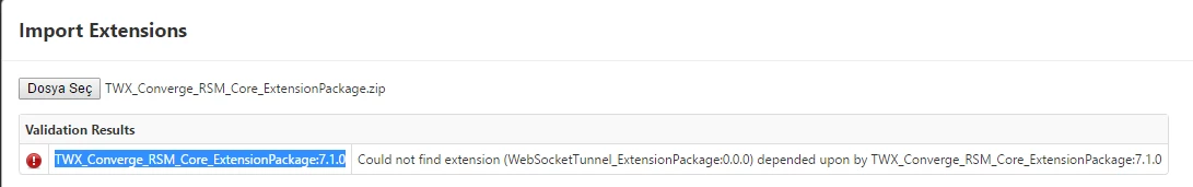

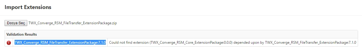

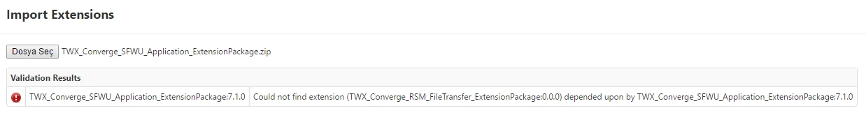

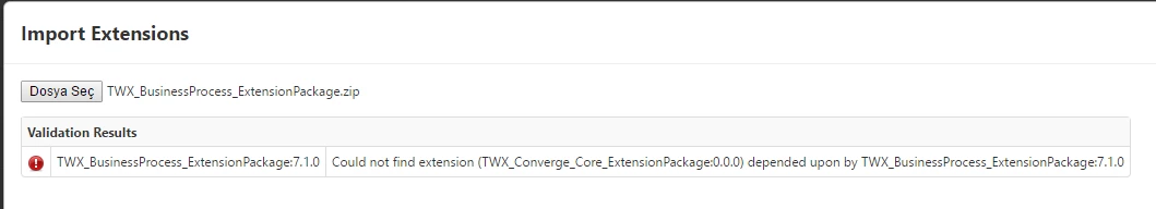

I had the same error shown in the attached pictures "Could not find the extension" while importing the extensions below:

The first screenshot - TWX_Converge_SFWU_Application_ExtensionPackage7.1.0_IMPORT_ERROR.png is stating that the SFWU extension package cannot be imported until the RSM FileTransfer package has been imported.
The second screenshot - TWX_Converge_RSM_FileTransfer_ExtensionPackage_IMPORT_ERROR.png is stating that the RSM FileTransfer extension package cannot be imported until the RSM Core package has been imported.
The third screenshot - TWX_Converge_RSM_Core_ExtensionPackage_IMPORT_ERROR.png is stating that the RSM Core extension package cannot be imported until the WebsocketTunnel package has been imported.
The fourth screenshot - TWX_BusinessProcess_ExtensionPacakage_IMPORT_ERROR.png is stating that the BPM extension package cannot be imported until the Converge Core extension package can be imported.
You will want to start with the ThingWorx-Utilities-7-1-0 extension package and import everything in there. After that, you can start importing these individual modules that extend upon ThingWorx Utilities.
