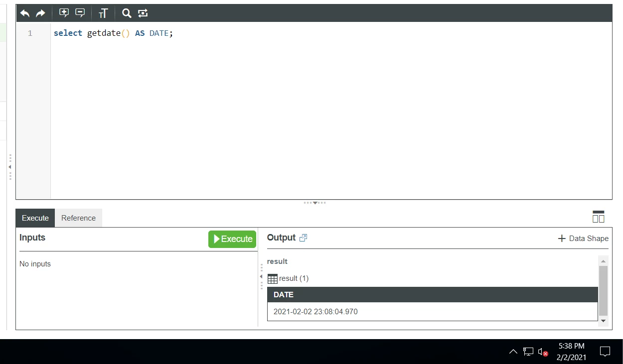

I have installed thingworx foundation with sql. I created a new thing (mssql template) and connected it successfully. But writing a new query (select getdate()) returns wrong date. It adds 5 hours with the current date. But when executed in sql it returns correct date but in thingworx it returns wrong date. What could be the issue?

As you have mentioned you installed Thingworx 9.1 with installer then you might know this particular version installer changes OS TimeZone to UTC. Here is an article for details: New TimeZone Setting in Thingworx 9.x
Now even though you are running Thingworx on your local machine which has a different timezone but your result obtained will be in UTC.
But if Thingworx or DB query ran on the server itself it will give correct result.

Where have you installed your Thingworx. Is it local or on the server? If on the server, please check the Server Date Timings format. That's why it displays mismatch in the timings. If it's on the Server which is not hosted locally, go and run the date command and validate the timings and match with your local timings.
Hi @Riz-4165786 ,
Its on server and it already matches the local timing.
Is your sql DB server also on the same server? It has something to do with server timings. I can't think of anything else other than this.
