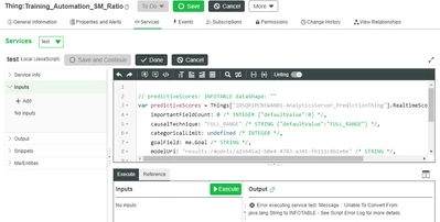

I made a model using analytics builder, and I want to use this model with real run-time data. How do I connect my real run time data with the model I created in analytics builder? Please provide me a step-by-step tutorial since it's my first time using Thingworx analytics builder.

You may find this post Solved: Analytics: Prediction Methods Mashup - PTC Community of interest.
It has a sample mashup that call a things with several services to do, among other thing a Realtime score, so you probably can use this as an example.
