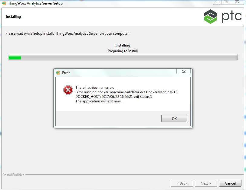

While installing the thingworx analytics server 8.0 in local i got the following error(screenshot attached). Is there any workaround for this docker issue?

Hi
This looks similar to the issue reported at https://support.ptc.com/appserver/cs/view/solution.jsp?n=CS264269
You should check your version of docker and possibly downgrade it if it is too recent as indicated in the above article.
Christophe
June 23, 2017
Thank you it worked,
