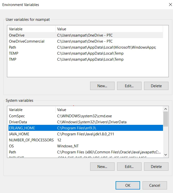

My issue is similar to this thread, however I have followed the documentation I believe: https://community.ptc.com/t5/ThingWorx-Developers/Issues-installing-Analytics-Setup-ERLANG-HOME/m-p/655100
I have Thingworx Foundation installed, now I need to install Analytics.
Analytics installation fails. Specifically, "ERLANG_HOME system environment variable is not set correctly. Set ERLANG_HOME to point to where Erlang software is located, for example, C:\Program Files\erl10.0"
I do have installed Erlang and set the environment variable for the system. The installation of Analytics still fails.
Possibly relevant: I have not yet installed Analytics Server, as I don't think that is required.
To troubleshoot this issue I have done the following:
I have set the environment variable to
C:\Program Files\erl10.0\
C:\Program Files\erl10.0\bin\
I have uninstalled and reinstalled Erlang.
I have tried version 21.3 (latest supported version)
I have tried an earlier supported version 20.3 (currently installed).
I have done a few restarts.
Thanks for any assistance you can provide.

Hello @Matt-H ,
Thank you for posting to the PTC Community.
I understand you are having difficulty with deploying ThingWorx Analytics, around the Erlang pre-requisite.
Can you provide more specifics, as Erlang is not required for the Base Application, ThingWorx Analytics Server. Erlang is required for ThingWorx Platform Analytics, which is a separate application.
Are you able to provide the versions of ThingWorx Platform Server, ThingWorx Analytics Server you wish to deploy?
Also, please note, these variables must be set as a System Variable, not a User Variable.
Neel
May 29, 2020
@Matt-H ,
As a followup, I have taken a screenshot of my working ERLANG_HOME for your reference.
Please note the location highlighted in my screenshot:
Neel
