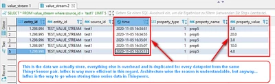

Due to the way Thingworx uses PostgreSQL, there is quite a big overhead in terms or number of rows when storing data (each datapoint for each sensor takes one row so for 100 assets x 3 properties you'd get 100x3 rows every 5 seconds in the Stream table. That would be 300x12x60x24=~5 200 000rows per day.
Storage-wise there is also quite a major overhead. The screenshot below shows a sample row (storing 1 datapoint (value=) for 1 sensor).
I'm not prepared to share exact numbers (that would take some time to double-check everything to make sure), but if I didn't confuse something major, for PostgreSQL one needs like ~40 times more storage space).
