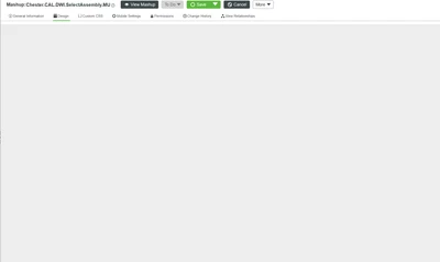

Thingworx Composer mashup design tab is empty
Can not edit mashup, the design tab is empty, but I can view the mashup, please help

7-Bedrock
Sep 12, 2024 6:12 AM UTC
Thanks, it was solved after I re-deploy thingworx, it seems some files were missed in thingworx folder
