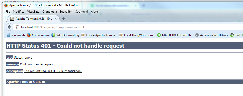

Hi All,
today I installed on my PC Oracle Client 12.0 and then I uninstalled it.
After that I started Tomcat and I'm connect to Composer in local thingworx instance, the url returned the following message :
I'm not requested to enter the login/password andf the url returned the page before.
Any suggestion .. I would like to avoid to reinstall all the environment.
In case I have to reinstall  how canI restore data (stored in neo4j).
Is it possibile afther the new installation to link the old db ?
Many Thanks
BR
Dimitri

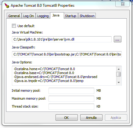

Hi Dimitri, what's the error message in the tomcat's catalina log? is the Tomcat running while you get that error? You might want to confirm if somehow the Java settings are changed/updated for the Tomcat after you uninstalled the Oracle client.

Could you please verify that your Tomcat java path is set to (with your own java version):
Java\jre1.8.0_121\bin\server\jvm.dll
March 20, 2017
Hi Polina,
the path is correct
BR
