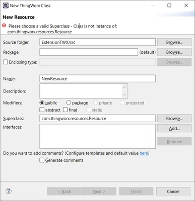

Trying to create a "Resource" with Eclipse as a Thingworx Extension.
While creating a Resource getting a following error,
Please choose a valid Superclass - Class is not instance of: com.thingworx.resources.Resource

Not facing any error while creating "ThingTemplate" or "ThingShape".
