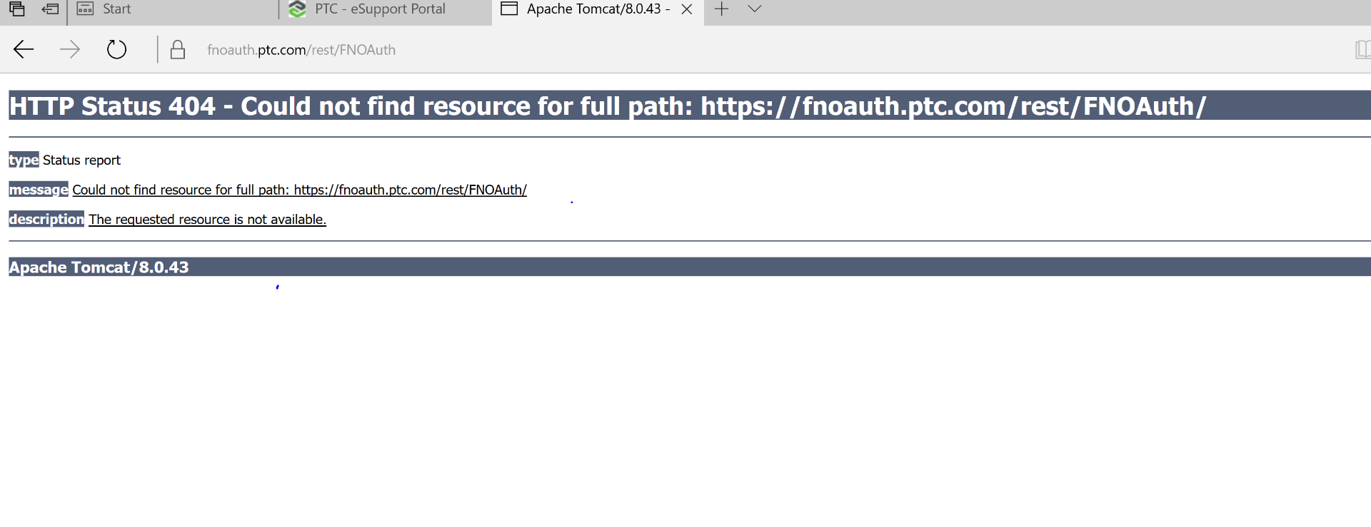

I am trying to download license.bin as instructed as part of thingworx installation..
getting failure message as posted below.
Any help will be greatly appreciated.
RM
September 5, 2017
Hi Rashmita, this could be a temporary issue. For how long have you been trying to download the file? If it has been a while you might want to reach out to your sales or open a license support case.

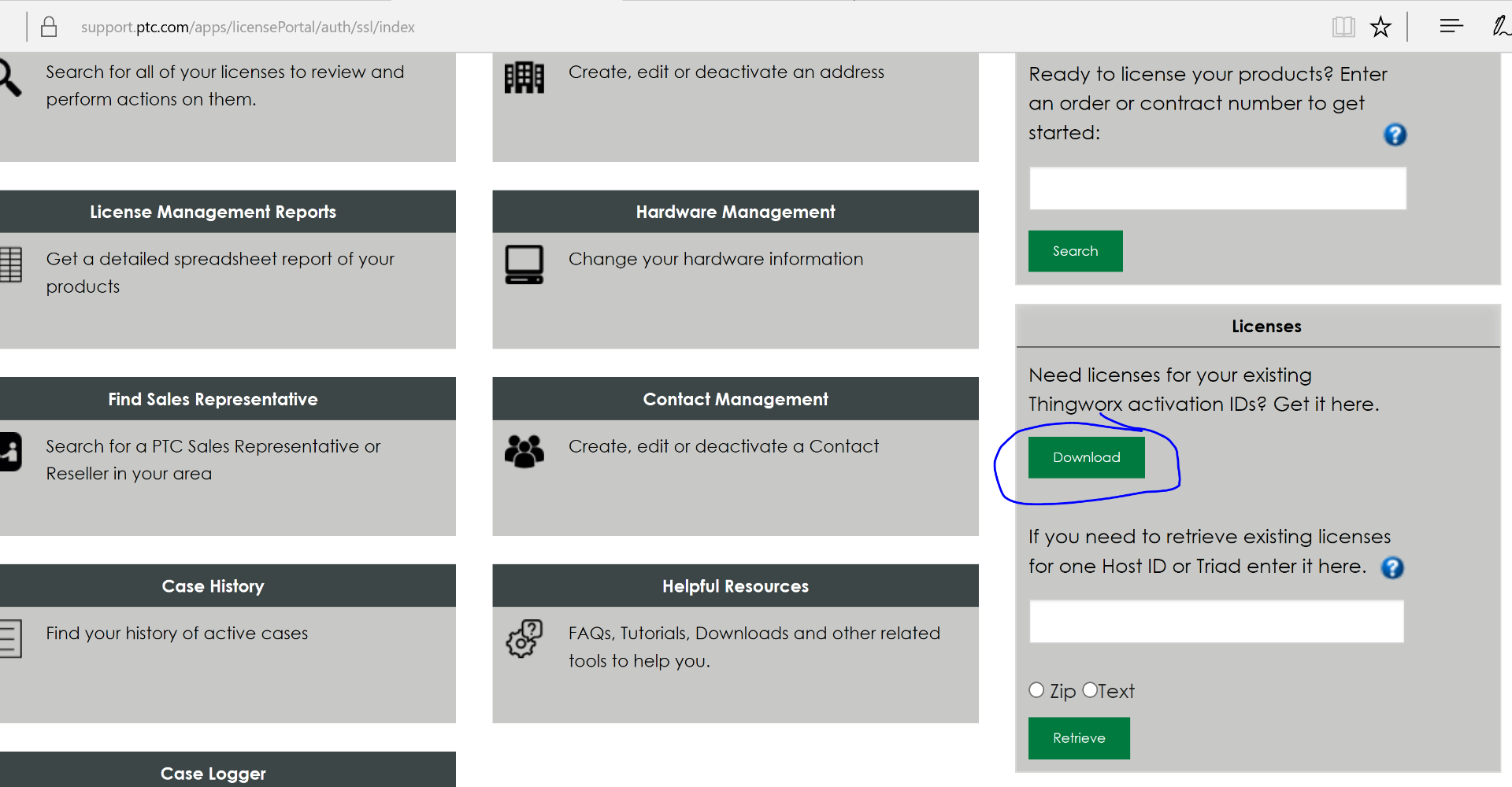

Hi Rashmita,
What happens when you click on the Download button on the License Management page? Ideally the license ( which is a .bin file) should get downloaded .
If you were able to download the file but faced issues while launching the Thingworx application , ensure that you have followed the below steps.
  • Download the license from the PTC Support site
  • Rename the .bin file to license.bin
  • Create ThingworxPlatform folder at the root of the drive where Tomcat was installed
  • Make sure the ThingworxPlatform folder has Read Write access
  • Place the license.bin in the ThingworxPlatform folder
  • Restart Tomcat and try launching the Composer again.
If you were not able to download the file at all , then please reach out to the sales dept as mentioned by Sushant.
