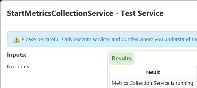

Could you try running StartMetricsCollectionService service in the platform service to see if it helps.

I tried to start the StartMetricsCollectionService service. The result of this operation was positive.
However, when I try to activate the “ThingWorx Metrics Reporting Services”, there is the same error.
