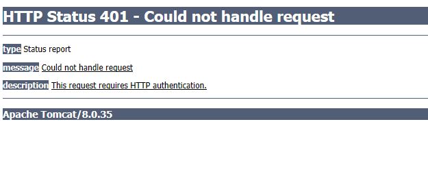

Good afternoon!
Installed on my computer Thingworx 8.0
Windows 10
Tomcat 8.0.44
Postgresql 9.4.12
Java: jdk-8u131-windows-x64
Installation conducted on video instructions
As a result, I received a screen with an error.
I reinstalled many times, including instructions.
Tried to install:
At startup either a white screen or an error 401.
I tried with versions 7.x - the same result
I ask for your help.
Thanks for every answer.

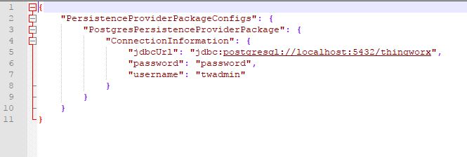

What  does your platform-settings.json look like? Where is your ThingworxPlatform folder located?

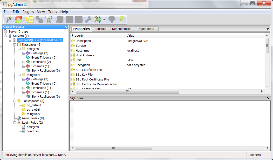

If you open your pgadmin III and expand the thingworx database all the way, how many tables are you seeing?
atsarev1-VisitorAuthor
July 13, 2017

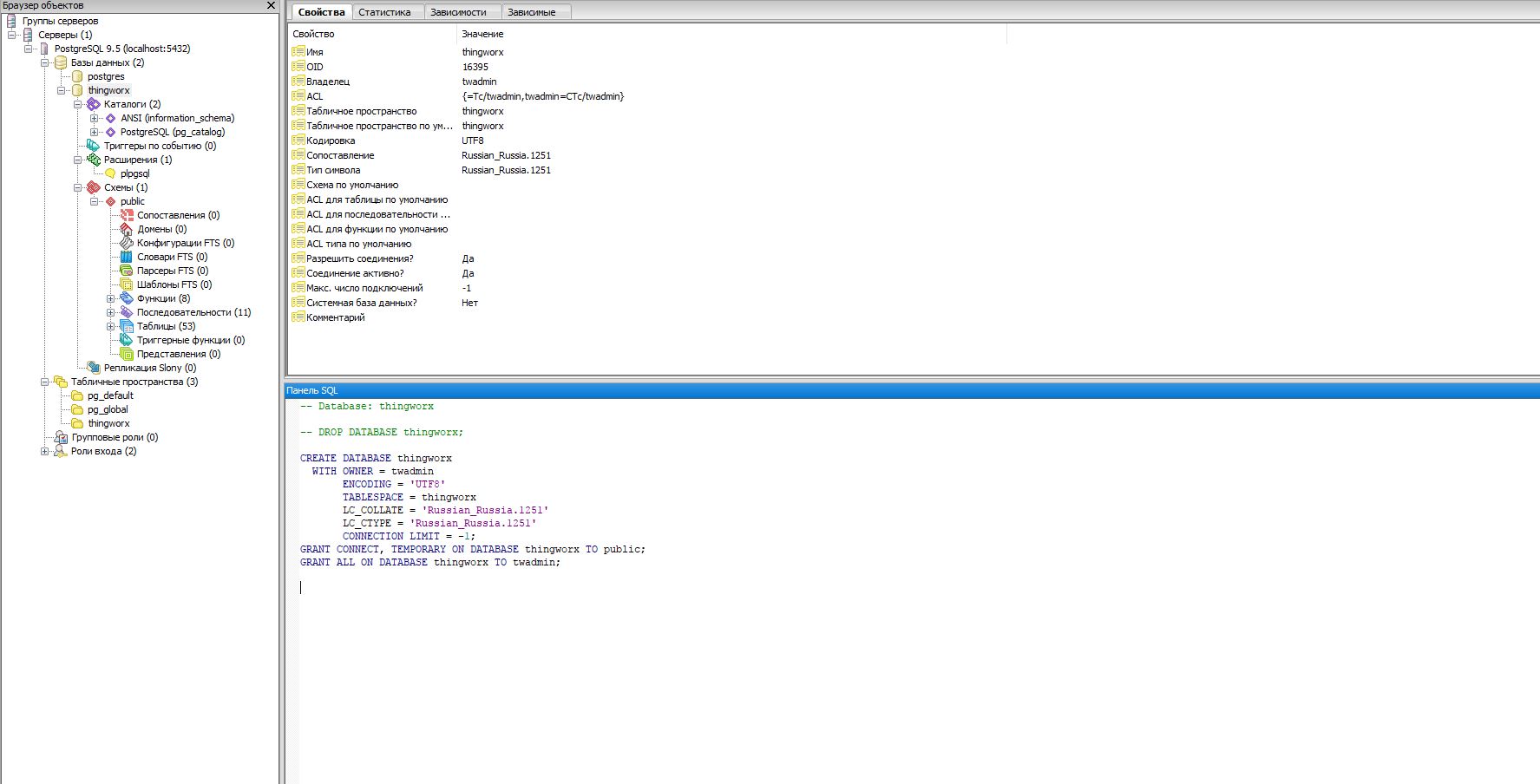

1. platform-settings.json
2. C:\ThingworxPlatform
All applications are on drive C
Tomchat and PostgraSK in the folder C: \ Program Files
3. pgadmin III

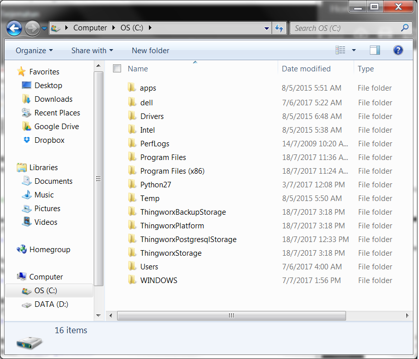

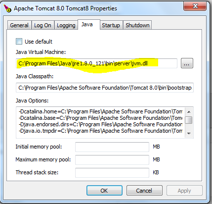

Could you please supply your tomcat configuration too, particularly this line?
Another thing to verify is that the folders ThingworxPostgresqlStorage and ThingworxPlatform both have permissions set on Everyone Full Control:

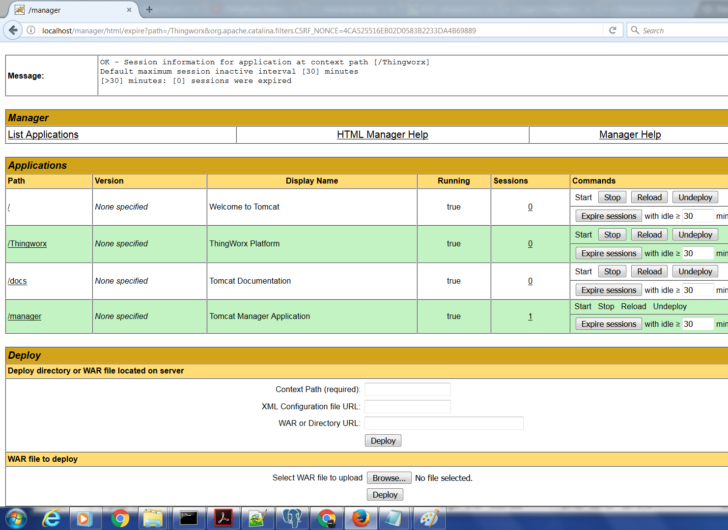

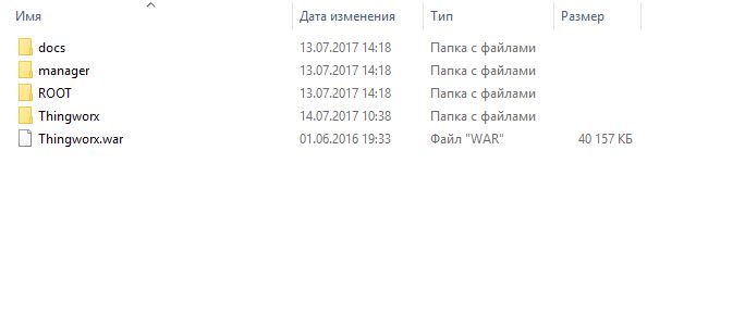

Hi Andrey, Could you please ensure that there is only one Thingworx folder under Tomcat/Webapps. Renamed previous folder might also cause the problem.
July 14, 2017
Hi Yamini.
In the folder one file .war and the folder Thingworx.
The screenshot has version 7.1 installed.
But I also copy file ".war" version 8.1.

Is Thingworx and DB on  same server .
Is database server accessible . Can you share your platform setting.json file.
July 17, 2017
Yes, on the same server.
The file platform-settings.json looks like this:
"PersistenceProviderPackageConfigs": {
"PostgresPersistenceProviderPackage": {
"ConnectionInformation": {
"jdbcUrl": "jdbc:postgresql://localhost:5432/thingworx",
"password": "password",
"username": "twadmin"
July 17, 2017
Have you changed the default schema name .
If the default schema name is changed (from public), you must add <databasename>?currentSchema=<name of schema>
For example, if the schema name is mySchema, it would be:
jdbc:postgresql://<DBServer>:<DBPort>/<databasename>?currentSchema=mySchema.
Can you please upload your platform setting.json file here . You  can remove the db username and and password if you want.

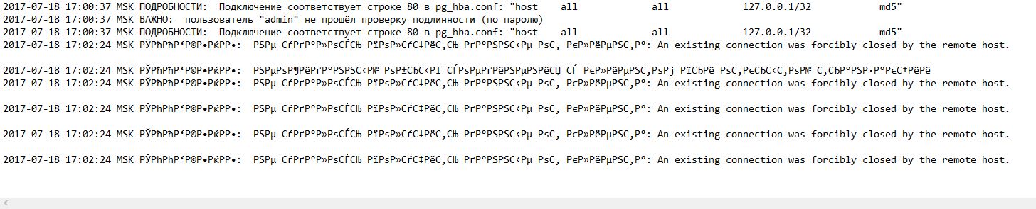

Same with me here,  (not answer only to share)
I have fully completed the Installation step in installation document for TW 8.0 and also TW 7.4 (plus video) in my fresh machine with windows 7. and when reaching the step to launch, go to
localhost/Thingworx
in my browser (Chrome 59, Firefox 54, IE 11) only get redirected to localhost/Thingworx/home with blank white screen.

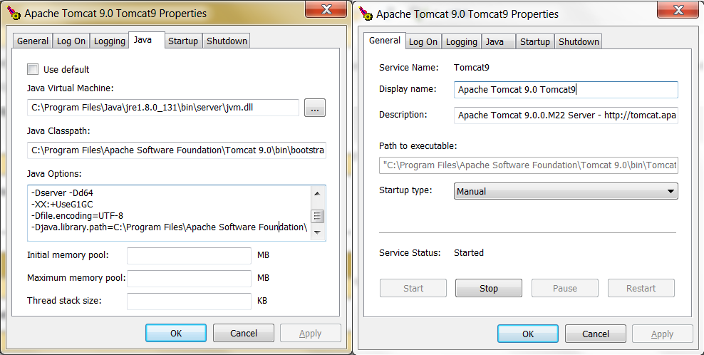

Here my Tomcat setting:
installation wizard with:
-HTTP/1.1 connection port 80
adding java options:
-Dserver -Dd64
-XX:+UseG1GC
-Dfile.encoding=UTF-8
-Djava.library.path=C:\Program Files\Apache Software Foundation\Tomcat 9.0\webapps\Thingworx\WEB-INF\extensions

Here my postgreSQL (pgAdmin3) setting:

create folder C:\ThingworxPostgresqlStorage

tomcat setting
postgreSQL
folder :
Tomcat server localhost :
and here the log (Applicationlog) :
2017-07-18 15:40:55.403+0700 [L: INFO] [O: c.t.s.ThingWorxBootstrapper] [I: ] [U: SuperUser] [S: ] [T: http-nio-80-exec-9] ========================================
2017-07-18 15:40:55.404+0700 [L: INFO] [O: c.t.s.ThingWorxBootstrapper] [I: ] [U: SuperUser] [S: ] [T: http-nio-80-exec-9] ThingWorx Version Information
2017-07-18 15:40:55.404+0700 [L: INFO] [O: c.t.s.ThingWorxBootstrapper] [I: ] [U: SuperUser] [S: ] [T: http-nio-80-exec-9] ========================================
2017-07-18 15:40:55.406+0700 [L: INFO] [O: c.t.s.ThingWorxBootstrapper] [I: ] [U: SuperUser] [S: ] [T: http-nio-80-exec-9] majorVersion = 8
2017-07-18 15:40:55.406+0700 [L: INFO] [O: c.t.s.ThingWorxBootstrapper] [I: ] [U: SuperUser] [S: ] [T: http-nio-80-exec-9] minorVersion = 0
2017-07-18 15:40:55.406+0700 [L: INFO] [O: c.t.s.ThingWorxBootstrapper] [I: ] [U: SuperUser] [S: ] [T: http-nio-80-exec-9] revision = 1
2017-07-18 15:40:55.406+0700 [L: INFO] [O: c.t.s.ThingWorxBootstrapper] [I: ] [U: SuperUser] [S: ] [T: http-nio-80-exec-9] build = b39
2017-07-18 15:40:55.407+0700 [L: INFO] [O: c.t.s.ThingWorxBootstrapper] [I: ] [U: SuperUser] [S: ] [T: http-nio-80-exec-9] schemaVersion = 1000
2017-07-18 15:40:55.408+0700 [L: INFO] [O: c.t.s.ThingWorxBootstrapper] [I: ] [U: SuperUser] [S: ] [T: http-nio-80-exec-9] ========================================
2017-07-18 15:40:55.408+0700 [L: INFO] [O: c.t.s.ThingWorxBootstrapper] [I: ] [U: SuperUser] [S: ] [T: http-nio-80-exec-9] ThingWorx System Environment Settings
2017-07-18 15:40:55.408+0700 [L: INFO] [O: c.t.s.ThingWorxBootstrapper] [I: ] [U: SuperUser] [S: ] [T: http-nio-80-exec-9] OS: Windows 7
2017-07-18 15:40:55.408+0700 [L: INFO] [O: c.t.s.ThingWorxBootstrapper] [I: ] [U: SuperUser] [S: ] [T: http-nio-80-exec-9] OS arch: amd64
2017-07-18 15:40:55.408+0700 [L: INFO] [O: c.t.s.ThingWorxBootstrapper] [I: ] [U: SuperUser] [S: ] [T: http-nio-80-exec-9] OS version: 6.1
2017-07-18 15:40:55.410+0700 [L: INFO] [O: c.t.s.ThingWorxBootstrapper] [I: ] [U: SuperUser] [S: ] [T: http-nio-80-exec-9] Total Processors: 8
2017-07-18 15:40:55.410+0700 [L: INFO] [O: c.t.s.ThingWorxBootstrapper] [I: ] [U: SuperUser] [S: ] [T: http-nio-80-exec-9] Default encoding: UTF-8
2017-07-18 15:40:55.410+0700 [L: INFO] [O: c.t.s.ThingWorxBootstrapper] [I: ] [U: SuperUser] [S: ] [T: http-nio-80-exec-9] JAVA vendor: Oracle Corporation
2017-07-18 15:40:55.410+0700 [L: INFO] [O: c.t.s.ThingWorxBootstrapper] [I: ] [U: SuperUser] [S: ] [T: http-nio-80-exec-9] JAVA version: 1.8.0_131
2017-07-18 15:40:55.410+0700 [L: INFO] [O: c.t.s.ThingWorxBootstrapper] [I: ] [U: SuperUser] [S: ] [T: http-nio-80-exec-9] JAVA install location: C:\Program Files\Java\jre1.8.0_131
2017-07-18 15:40:55.410+0700 [L: INFO] [O: c.t.s.ThingWorxBootstrapper] [I: ] [U: SuperUser] [S: ] [T: http-nio-80-exec-9] JVM Max Memory: 4072 (MB)
2017-07-18 15:40:55.410+0700 [L: INFO] [O: c.t.s.ThingWorxBootstrapper] [I: ] [U: SuperUser] [S: ] [T: http-nio-80-exec-9] ========================================
2017-07-18 15:40:55.410+0700 [L: INFO] [O: c.t.s.ThingWorxBootstrapper] [I: ] [U: SuperUser] [S: ] [T: http-nio-80-exec-9] WebApp starting...
2017-07-18 15:40:55.745+0700 [L: INFO] [O: c.t.s.ThingWorxServer] [I: ] [U: SuperUser] [S: ] [T: http-nio-80-exec-9] HA mode not enabled. Initializing and starting in standalone mode.
2017-07-18 15:40:55.746+0700 [L: INFO] [O: c.t.s.ThingWorxPersistenceHandler] [I: ] [U: SuperUser] [S: ] [T: http-nio-80-exec-9] Default Persistence Provider Name = ThingworxPersistenceProvider
2017-07-18 15:40:55.746+0700 [L: INFO] [O: c.t.s.ThingWorxPersistenceHandler] [I: ] [U: SuperUser] [S: ] [T: http-nio-80-exec-9] Default Persistence Provider Package Name = PostgresPersistenceProviderPackage
2017-07-18 15:40:55.755+0700 [L: INFO] [O: c.t.p.p.PostgresDatasource] [I: ] [U: SuperUser] [S: ] [T: http-nio-80-exec-9] Reading configuration from configTableCol
2017-07-18 15:40:55.978+0700 [L: INFO] [O: c.t.s.ThingWorxServer] [I: ] [U: SuperUser] [S: ] [T: http-nio-80-exec-9] Managers...INITIALIZED
2017-07-18 15:40:55.981+0700 [L: INFO] [O: c.t.s.ThingWorxServer] [I: ] [U: SuperUser] [S: ] [T: http-nio-80-exec-9] Database initialization started...
2017-07-18 15:41:26.398+0700 [L: WARN] [O: c.m.v.r.BasicResourcePool] [I: ] [U: SuperUser] [S: ] [T: C3P0PooledConnectionPoolManager[identityToken->1hge1iz9pnjm6g61ngzq4t|a6b6c9e]-HelperThread-#1] com.mchange.v2.resourcepool.BasicResourcePool$ScatteredAcquireTask@34a6964b -- Acquisition Attempt Failed!!! Clearing pending acquires. While trying to acquire a needed new resource, we failed to succeed more than the maximum number of allowed acquisition attempts (3). Last acquisition attempt exception:
2017-07-18 15:41:26.399+0700 [L: WARN] [O: c.m.v.r.BasicResourcePool] [I: ] [U: SuperUser] [S: ] [T: C3P0PooledConnectionPoolManager[identityToken->1hge1iz9pnjm6g61ngzq4t|a6b6c9e]-HelperThread-#1] Having failed to acquire a resource, com.mchange.v2.resourcepool.BasicResourcePool@d22ce38 is interrupting all Threads waiting on a resource to check out. Will try again in response to new client requests.
2017-07-18 15:41:26.399+0700 [L: WARN] [O: c.m.v.r.BasicResourcePool] [I: ] [U: SuperUser] [S: ] [T: C3P0PooledConnectionPoolManager[identityToken->1hge1iz9pnjm6g61ngzq4t|a6b6c9e]-HelperThread-#2] com.mchange.v2.resourcepool.BasicResourcePool$ScatteredAcquireTask@23cf9c7b -- Acquisition Attempt Failed!!! Clearing pending acquires. While trying to acquire a needed new resource, we failed to succeed more than the maximum number of allowed acquisition attempts (3). Last acquisition attempt exception:
2017-07-18 15:41:26.403+0700 [L: WARN] [O: c.m.v.r.BasicResourcePool] [I: ] [U: SuperUser] [S: ] [T: C3P0PooledConnectionPoolManager[identityToken->1hge1iz9pnjm6g61ngzq4t|a6b6c9e]-HelperThread-#2] Having failed to acquire a resource, com.mchange.v2.resourcepool.BasicResourcePool@d22ce38 is interrupting all Threads waiting on a resource to check out. Will try again in response to new client requests.
2017-07-18 15:41:26.406+0700 [L: WARN] [O: c.m.v.r.BasicResourcePool] [I: ] [U: SuperUser] [S: ] [T: C3P0PooledConnectionPoolManager[identityToken->1hge1iz9pnjm6g61ngzq4t|a6b6c9e]-HelperThread-#5] com.mchange.v2.resourcepool.BasicResourcePool$ScatteredAcquireTask@41754979 -- Acquisition Attempt Failed!!! Clearing pending acquires. While trying to acquire a needed new resource, we failed to succeed more than the maximum number of allowed acquisition attempts (3). Last acquisition attempt exception:
2017-07-18 15:41:26.406+0700 [L: ERROR] [O: c.t.s.ThingWorxServer] [I: ] [U: SuperUser] [S: ] [T: http-nio-80-exec-9] [message: Connections could not be acquired from the underlying database!]
2017-07-18 15:41:26.406+0700 [L: WARN] [O: c.m.v.r.BasicResourcePool] [I: ] [U: SuperUser] [S: ] [T: C3P0PooledConnectionPoolManager[identityToken->1hge1iz9pnjm6g61ngzq4t|a6b6c9e]-HelperThread-#5] Having failed to acquire a resource, com.mchange.v2.resourcepool.BasicResourcePool@d22ce38 is interrupting all Threads waiting on a resource to check out. Will try again in response to new client requests.
2017-07-18 15:41:26.411+0700 [L: INFO] [O: c.t.p.p.PersistenceProvider] [I: ] [U: SuperUser] [S: ] [T: http-nio-80-exec-9] Connection ThingworxPersistenceProvider, type PostgresPersistenceProviderPackage stopped
2017-07-18 15:41:26.411+0700 [L: WARN] [O: c.t.p.p.PersistenceProvider] [I: ] [U: SuperUser] [S: ] [T: http-nio-80-exec-9] Could not find persistenceProviderPackage PostgresPersistenceProviderPackage and thus could not stop data processing
2017-07-18 15:41:26.413+0700 [L: ERROR] [O: c.t.s.ThingWorxBootstrapper] [I: ] [U: SuperUser] [S: ] [T: http-nio-80-exec-9] [message: Unable to initialize and start system: Connections could not be acquired from the underlying database!]
2017-07-18 15:41:26.413+0700 [L: ERROR] [O: c.t.s.ThingWorxBootstrapper] [I: ] [U: SuperUser] [S: ] [T: http-nio-80-exec-9] *** Web Application STATE is being set to ERROR! ***
2017-07-18 15:41:26.422+0700 [L: WARN] [O: c.m.v.r.BasicResourcePool] [I: ] [U: SuperUser] [S: ] [T: C3P0PooledConnectionPoolManager[identityToken->1hge1iz9pnjm6g61ngzq4t|a6b6c9e]-HelperThread-#0] com.mchange.v2.resourcepool.BasicResourcePool$ScatteredAcquireTask@625ac15d -- Acquisition Attempt Failed!!! Clearing pending acquires. While trying to acquire a needed new resource, we failed to succeed more than the maximum number of allowed acquisition attempts (3). Last acquisition attempt exception:
2017-07-18 15:41:26.422+0700 [L: WARN] [O: c.m.v.r.BasicResourcePool] [I: ] [U: SuperUser] [S: ] [T: C3P0PooledConnectionPoolManager[identityToken->1hge1iz9pnjm6g61ngzq4t|a6b6c9e]-HelperThread-#0] Having failed to acquire a resource, com.mchange.v2.resourcepool.BasicResourcePool@d22ce38 is interrupting all Threads waiting on a resource to check out. Will try again in response to new client requests.
2017-07-18 15:41:26.428+0700 [L: WARN] [O: c.m.v.r.BasicResourcePool] [I: ] [U: SuperUser] [S: ] [T: C3P0PooledConnectionPoolManager[identityToken->1hge1iz9pnjm6g61ngzq4t|a6b6c9e]-HelperThread-#6] com.mchange.v2.resourcepool.BasicResourcePool$ScatteredAcquireTask@624e1793 -- Acquisition Attempt Failed!!! Clearing pending acquires. While trying to acquire a needed new resource, we failed to succeed more than the maximum number of allowed acquisition attempts (3). Last acquisition attempt exception:
2017-07-18 15:41:26.429+0700 [L: WARN] [O: c.m.v.r.BasicResourcePool] [I: ] [U: SuperUser] [S: ] [T: C3P0PooledConnectionPoolManager[identityToken->1hge1iz9pnjm6g61ngzq4t|a6b6c9e]-HelperThread-#6] Having failed to acquire a resource, com.mchange.v2.resourcepool.BasicResourcePool@d22ce38 is interrupting all Threads waiting on a resource to check out. Will try again in response to new client requests.
2017-07-18 15:42:10.050+0700 [L: ERROR] [O: c.t.s.a.AuthenticationFilter] [I: ] [U: ] [S: ] [T: http-nio-80-exec-12] Could not handle request
2017-07-18 15:57:56.022+0700 [L: ERROR] [O: c.t.s.a.AuthenticationFilter] [I: ] [U: ] [S: ] [T: http-nio-80-exec-14] Could not handle request
2017-07-18 15:58:15.163+0700 [L: ERROR] [O: c.t.s.a.AuthenticationFilter] [I: ] [U: SuperUser] [S: ] [T: http-nio-80-exec-16] Could not handle request
2017-07-18 15:59:32.865+0700 [L: ERROR] [O: c.t.s.a.AuthenticationFilter] [I: ] [U: ] [S: ] [T: http-nio-80-exec-11] Could not handle request
this :
2017-07-18 15:39:12.143+0700 [L: ERROR] [O: S.c.t.s.a.AuthenticationFilter] [I: ] [U: ] [S: ] [T: http-nio-80-exec-4] Could not handle request
2017-07-18 15:39:19.515+0700 [L: ERROR] [O: S.c.t.s.a.AuthenticationFilter] [I: ] [U: ] [S: ] [T: http-nio-80-exec-6] Could not handle request
2017-07-18 15:40:08.154+0700 [L: ERROR] [O: S.c.t.s.a.AuthenticationFilter] [I: ] [U: SuperUser] [S: ] [T: http-nio-80-exec-3] Could not handle request
2017-07-18 15:41:26.439+0700 [L: INFO] [O: S.c.t.s.a.s.SSOContext] [I: ] [U: SuperUser] [S: ] [T: http-nio-80-exec-9] SSOContext created...
2017-07-18 15:41:26.516+0700 [L: ERROR] [O: S.c.t.s.a.AuthenticationFilter] [I: ] [U: SuperUser] [S: ] [T: http-nio-80-exec-9] Could not load session timeout from database, using default: null
2017-07-18 15:41:26.523+0700 [L: INFO] [O: S.c.t.s.s.SCIMProvider] [I: ] [U: SuperUser] [S: ] [T: http-nio-80-exec-9] Initializing SCIMProvider servlet...
2017-07-18 15:41:26.524+0700 [L: ERROR] [O: S.c.t.s.s.SCIMProvider] [I: ] [U: SuperUser] [S: ] [T: http-nio-80-exec-9] SCIMProvider initialization failure.  Thingworx Server is not running
2017-07-18 15:42:10.048+0700 [L: ERROR] [O: S.c.t.s.a.AuthenticationFilter] [I: ] [U: ] [S: ] [T: http-nio-80-exec-12] Could not handle request
2017-07-18 15:57:56.022+0700 [L: ERROR] [O: S.c.t.s.a.AuthenticationFilter] [I: ] [U: ] [S: ] [T: http-nio-80-exec-14] Could not handle request
2017-07-18 15:58:15.161+0700 [L: ERROR] [O: S.c.t.s.a.AuthenticationFilter] [I: ] [U: SuperUser] [S: ] [T: http-nio-80-exec-16] Could not handle request
2017-07-18 15:59:32.864+0700 [L: ERROR] [O: S.c.t.s.a.AuthenticationFilter] [I: ] [U: ] [S: ] [T: http-nio-80-exec-11] Could not handle request
thats is, really needed guidance here, i have tried every possible configuration i know, but had same result and sometimes even worse .
"password": "12345678",
And if I leave "password" by default, it does not start Thingworx.
log:
If I specify in the platform-settings.json the login and password from tomcat - the error is the same.
What login and password do I need to specify in this file?
