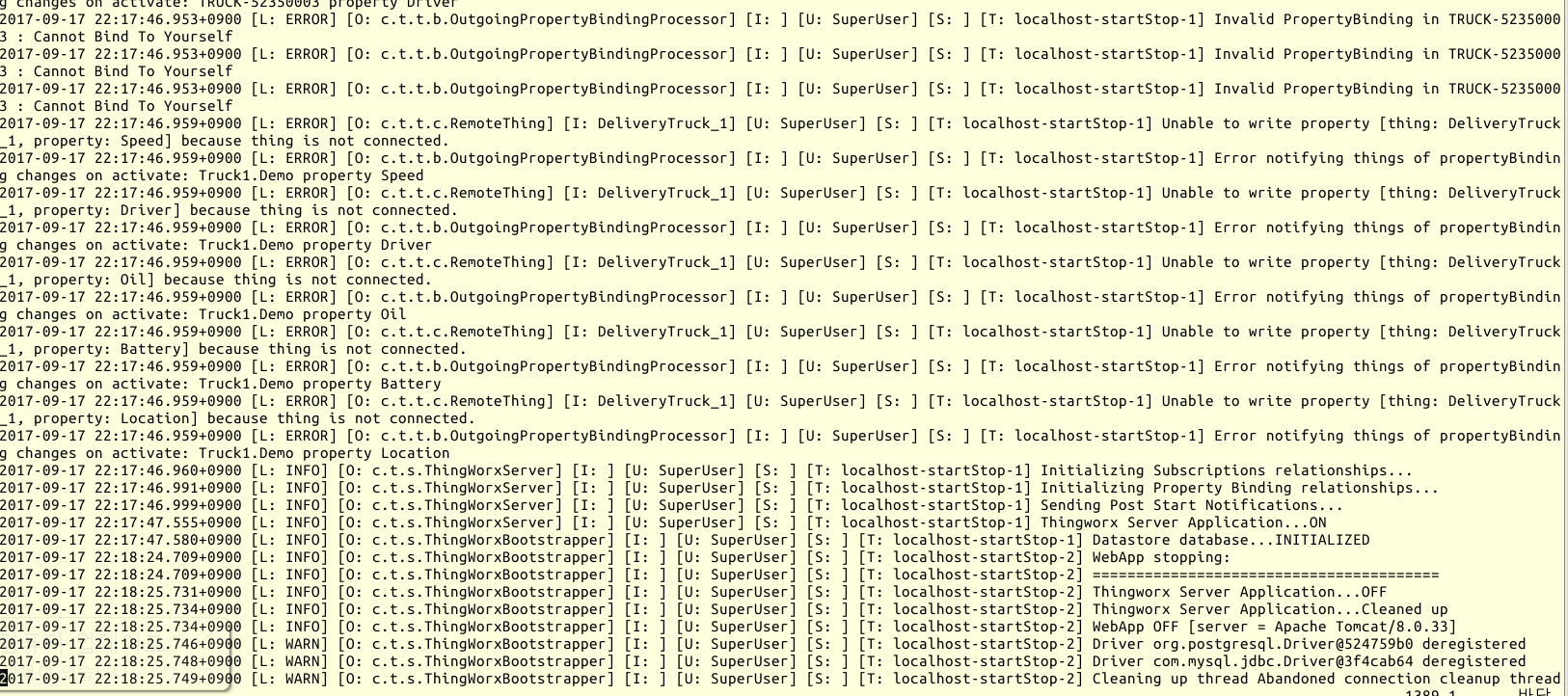

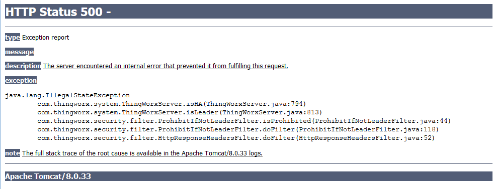

Hi, all.
I can't suddenly connect to the server.
I don't know why. This error occurs.
ApplicationLog
Actually, connection was smooth until just a few days ago.
Ubuntu 14.04, Tomcat8, Postgresql9.4..
Please help me T.T

Hi Jeongeun, just to confirm is PostgerSQL DB is up and running? Are you able to connect to it via PgAdminII client? Can you also share the tomcat logs?

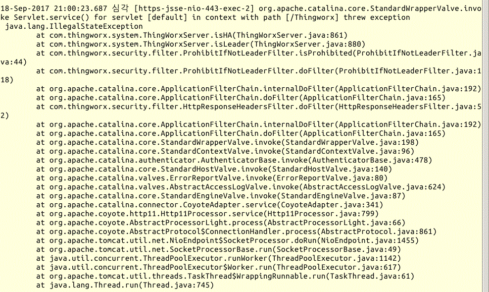

What does mean this error? I deleted everything. And I installed Thingworx8. However, the same error occurs.
help me.
September 18, 2017
Is it possible for you attach the applicationLog and Tomcat's catalina log here? It's bit hard to check for issues just with snippets of logs.

September 18, 2017
How do you deploy your application? Do you drop the .war file in Tomcat/webapps folder or upload via the browser? The browser/UI method would not work and likely  cause this error.
JUdging by the logs your database isn't connecting either.

September 18, 2017
I copied .war file under the webapps folder..

September 19, 2017
Have you ever installed a different version of postgres on the same machine? And what is your current version?
