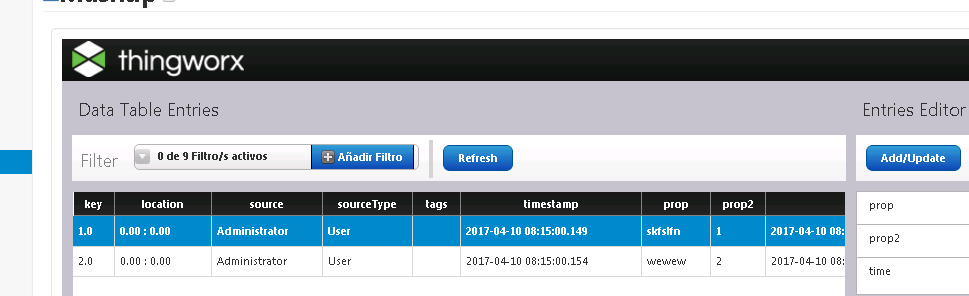

Hi
I am using ThingWorx 7.1.0-b484 with Postgres.
However I am using the default TW storage and I have noticed a strange behaviour in my data tables. Whenever a new entry is added to tje data table it reflects the date in the default column "timestamp" but does not reflect the time and shows the time as: 2017-04-10 00:00:00.000 for instance.
Kindly help in fixing this.
Best answer by posipova
This bug is Jira TW-7373. Fixed in 7.1.4 (and later), 7.2.0+, 7.3.0+.
This problem was occuring in the Postgres and H2 versions of the Platform because they populate the timestamp for Data Table entries using the java.sql.Date class which doesn't persist hours, minutes, seconds, and milliseconds.
posipova20-TurquoiseAnswer
20-Turquoise
April 10, 2017
