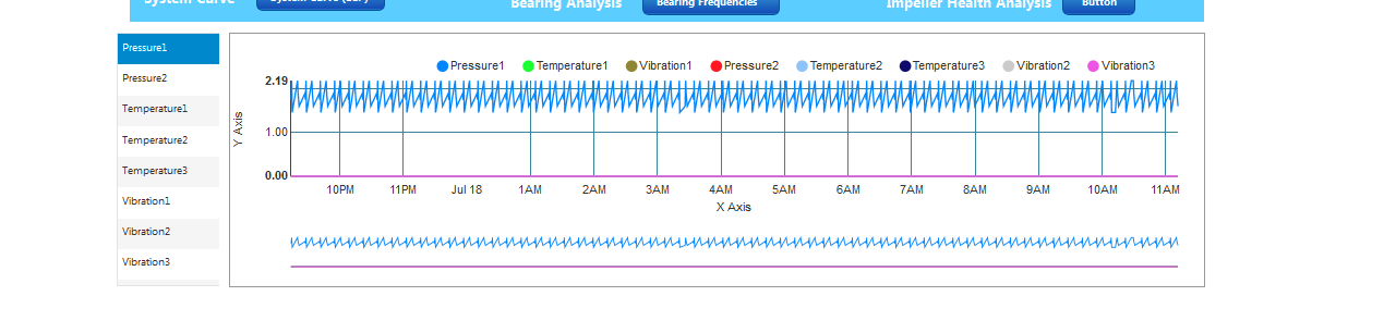

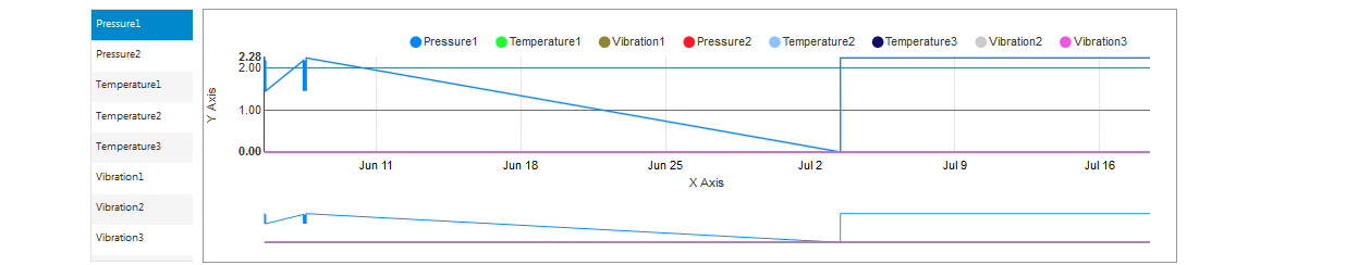

Dear Team,
I need to show time series chart using value stream. I have total 8 assets(things). In which some asset has same value and other one has random value.
As I have seen those asset has same value no value is logged.
As my asset2 has same value so graph will like.
For asset1 has  random value so graph will like
SO what is problem in case of asset2. Is logged property value is not get stored due to same value?

    If you wan't to record value changes whenever you receive a data point, still if it are exactly the same value, you need to set property "Data Change Info" to Always ( on Composer editing properties ). This is for the property itself, but if it's remote binded you may need to ensure that you are receiving Values always, you may need to tweak propertie's "Remote Binding Info" settings.
    Best Regards,
    Carles.

    Thanks Carles,
    As u mentioned said changes has done in thing (set property "Data Change Info" to Always ( on Composer editing properties )​). Also same changes has done in remotething. But still no changes on chart.
    July 18, 2017
    This will only apply for new data, old data it's already "lost".
