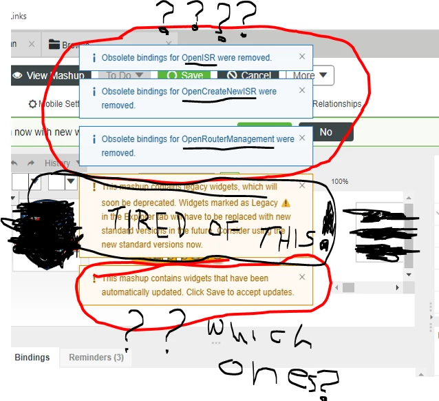

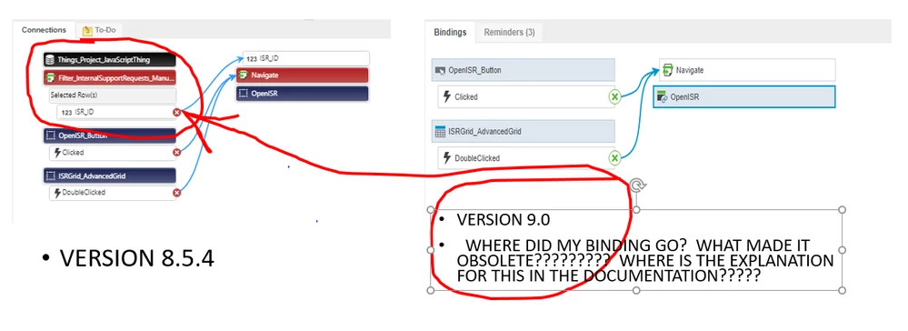

1.  Obsolete bindings for "....<Function Name>...." were removed.
I have found several now so far, and this has rendered my applications completely non-functional.  It appears that only the new (standard) Navigation functions are affected.  My legacy navigators are still completely functional and untouched.  What was the criteria for making these bindings obsolete?  I can find nothing in your documentation about this unexpected development.  The removed bindings passed IDs from the calling mashup, via a Navigator function, to the next mashup.  The same ID is being passed to other widgets and have not been touched.  So WHY are they being removed from my Navigators???  If I try to restore the bindings from the Navigator to my Javascript service via the new tool in the function window (I DO like that feature), and save the mashup, the binding gets removed again.  BUT, if I bind the ID field by going from my JavaScript service TO the navigator, it works and I can save it.  But the bound mashup inside the navigator won't recognize the passed values and fails when viewing the mashup in the browser.  This makes absolutely no sense at all.
2.  Getting the following notice on some of my mashups: "This mashup contains widgets that have been automatically updated.  Click Save to accept updates."
It would be very nice to know WHICH WIDGETS were updated, WHY they were updated, and exactly WHAT the updates were.  I don't want to save them until I know what you did to my application without my permission or approval.  It would have been even MUCH better if you would throw up something that says "YOU HAVE THE FOLLOWING WIDGETS THAT REQUIRE THE FOLLOWING CHANGES:"...and list them.  No other development tool or IDE I have used in 25+ years has ever changed my code for me without telling me about it BEFORE doing it so I can take the proper steps.  It would have been very nice if you would have, at the bare minimum, included some kind of warnings that this was going to happen in your documentation.  I guess that's a bridge too far?  And I just discovered that if I click "View Mashup", it saves the changes anyway.  So I just got screwed.
3.  THE NAGWARE IS STILL THERE - I was told ON THE PHONE it would go away!
Nagware makes me see red.  I get it.  You want us to move to the new standard widgets.  And we will.  We CAN'T right now, for many reasons.  I have been seeing this nonsensical warning every day all year.  I KNOW it contains deprecated widgets.  I am NOT stupid!  My wife doesn't even nag at me as much as you do with this!  Put something in the preferences to turn the warning ON or OFF.  You have the offending widgets flagged in the explorer window...that's good enough.
4.  Connecting lines between widgets
They used to be a DIFFERENT color when you moused over them (green).  Now they are the same color (blue) but only bolded a bit.  Super difficult to see that, especially when you have a whole bunch of them grouped together.  Please put it back to a different color (give users a preference so they can choose a color that they can see.  That way you don't have to worry about pleasing color-blind and vision-impaired people).  What would REALLY be nice is if you could CLICK on a line and it STAYS highlighted so you can trace it up or down from source to target.
Compare 8.5.4 to 9.0: Removed "obsolete" binding...WHY?????Compare 8.5.4 to 9.0: Removed "obsolete" binding...WHY?????Screenshot of warnings.- no explanations givenScreenshot of warnings.- no explanations given

  1. Obsolete bindings issues - The intent of this functionality is to ensure the content of your mashup is valid.  We've observed cases while editing and bringing content through from many prior releases creates some data integrity issues that we aimed to correct.  Unfortunately, it may have cleaned up too much.  We have identified these cases especially with the "TargetMashup" property and they will be fixed in 9.0.1 and 9.0.2 patches respectively.
  2. We have fixed the issue to not show any message during auto-update scenarios in the 9.0.1 release.  9.0.3 release will also reduce the size of the messages so that isn't overwhelming.
  3. We are targeting a better handling of the deprecated widget warnings for the 9.1 release.
  4. We have passed along the color feedback for the binding lines to our UX team for evaluation.
