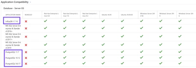

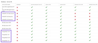

I'm going to upgrade TWX (better "Manual In Place Upgrade for Windows") from 9.0 to 9.1.
Currently we have PostgreSQL + Influx.
Comparing the Release Matrix, 9.0 vs 9.1, I've got:
9.0:
9.1:
Is it a mandatory precondition the migration of both databases, PostgreSQL and Influx, when switching from version 9.0 to 9.1?

Hi Tony, thank you so much!
According to the compatibility matrix the 1.8.X version is compatible only with Linux.
Does that mean that TWX needs to be installed in a Linux environment or that the InfluxDB should be installed in a Linux environment.
Thanks in advance.
