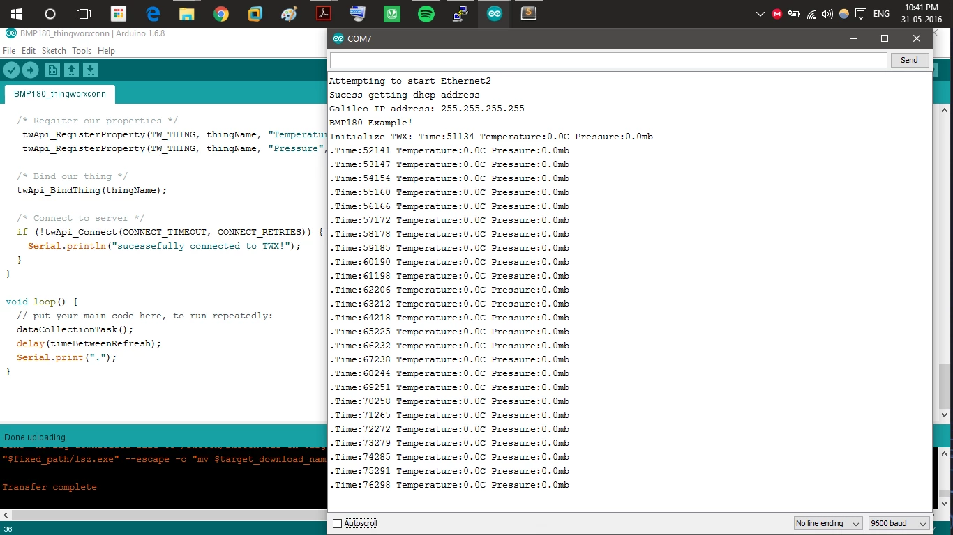

I'm trying to connect my Intel Galileo Gen 2 board to thingworkx. I'm following the tutorial  Weather Application with Intel Galileo | ThingWorx  . In the example, they have used the HTU21D sensor . As it wasn't available where I live, I'm performing the tutorial  using  a BMP180 sensor. I'm using it to sense temperature and pressure.
I have modified the code given for HTU21D , as follow for BMP180:
Note: For security reasons in have modified my API KEY and MAC address.

Every time when I burn the code to my board  the serial monitor waits for a while after printing "Initialize TWX:" and then start printing the temperature and pressure 0 without giving any information regarding the connection! ( In tutorial they have shown a message"successfully connected to TWX!"  when device is connected ) I have attached the screenshot of Serial Monitor and the original as well as modified code .
Please let me know where I'm going wrong  and quick response to this issue will be really appreciated as I have to give a demo to my fellow classmates on the day after tomorrow on IOT and ThingWorx.
