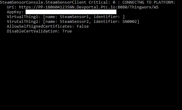

I have a trial account of ThingWorx and I want to test .NET sample but I can´t connect to ThingWorx.
First I created SteamSensor1, SteamSensor2 and SteamSensorAppKey in the composer.
My apiUri is: https://pp-1806041235nn.devportal.ptc.io/Thingworx
Is it okay?
I haven´t changed the code provided in the sample. I try the sample in debug mode with Visual Studio 2017.
These are my errors:
com.thingworx.communications.client.TwApiWrapper Error: 0 : [Error] Error intializing SSL connection
com.thingworx.communications.client.TwApiWrapper Error: 0 : [Error] twWs_Connect: Error restarting socket. Error 0
Best answer by konyicska
Well finally I figured out that my API uri was the problem:
Now my API uri is: https://PP-1806041235NN.Devportal.Ptc.Io:8080/Thingworx/WS
Then my Api Key has expired. To find this I had to display all errors in console. For that I changed
<add name="SourceSwitch" value="error" />
to
<add name="SourceSwitch" value="all" />
In App.config

Well finally I figured out that my API uri was the problem, maybe.
I haven´t any errors in my console but in Thingworx Composer SteamSensor things don´t update their isConnected property.
konyicska1-VisitorAuthorAnswer
July 6, 2018
to
In App.config
