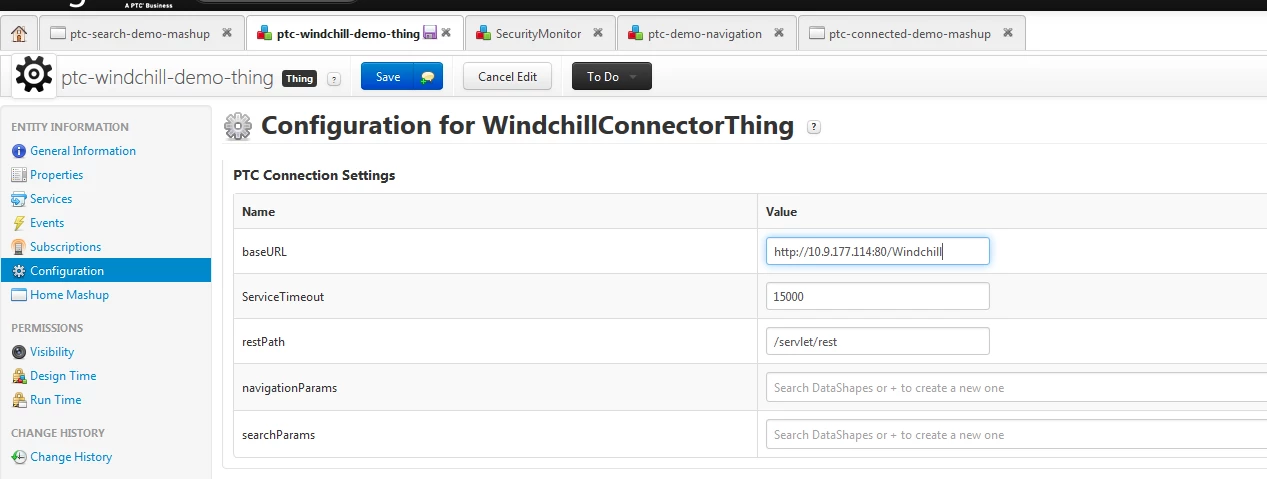

Single Signon is working fine using same as Windchill Login. I have set the url in Windchill connector thing

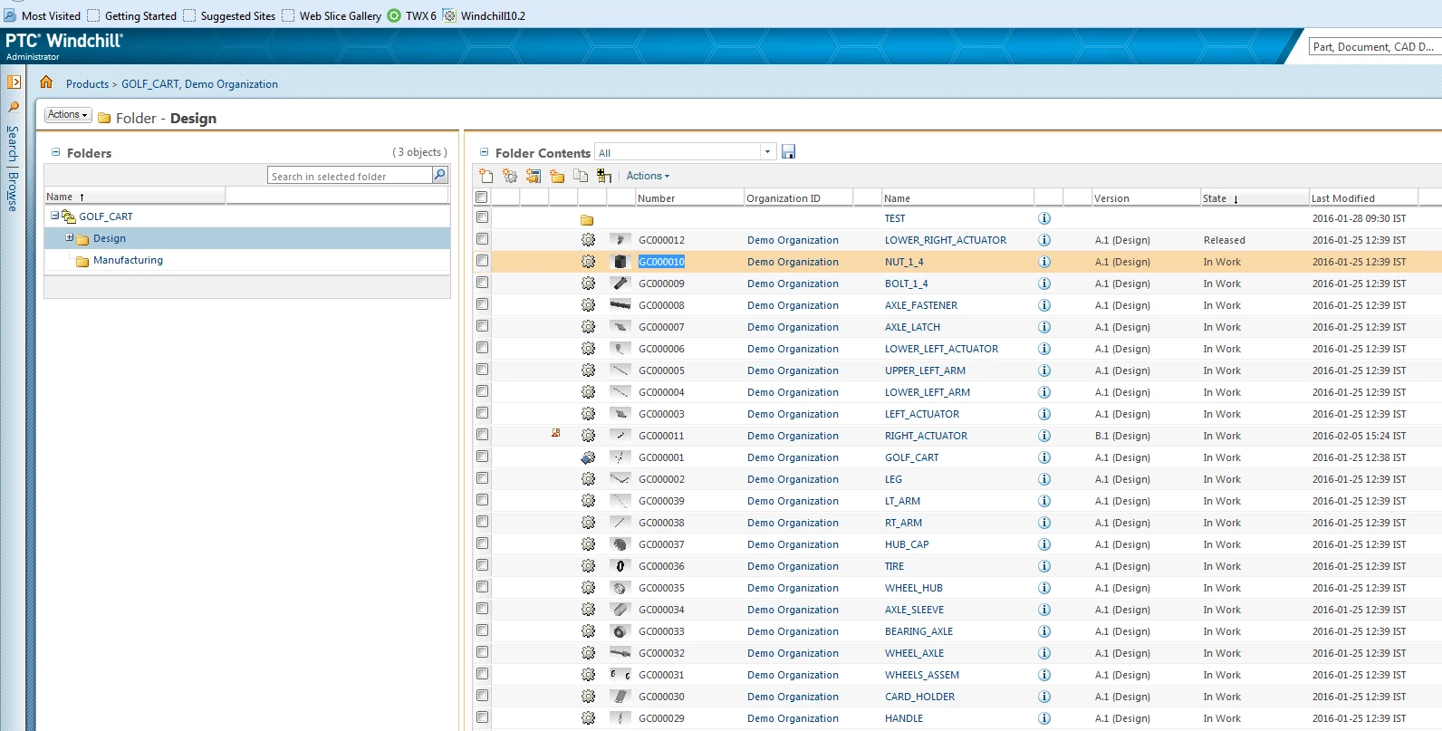

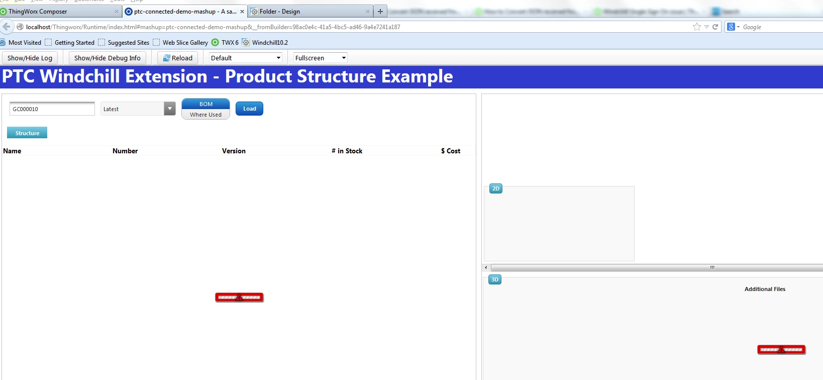

The problem None of the Windchill mashups are able to fetch the contents even though data exists is Windchill .
PFA files and let me know your inputs
Error:
18:10:19 ERROR - Runtime exception handling data update for binding {"SourceArea":"UI","TargetArea":"UI","TargetSection":"","SourceId":"InfotableSelector-64","SourceSection":"","Id":"a9c28e70-0cba-4d61-9399-d13e9bf20c03","PropertyMaps":[{"SourcePropertyType":"Property","TargetProperty":"SelectRowNumber","TargetPropertyType":"property","SourcePropertyBaseType":"INTEGER","TargetPropertyBaseType":"NUMBER","SourceProperty":"SelectRowNumber"}],"TargetId":"TreeTable-61","isBoundToSelectedRows":false,"SourceDetails":"AllData"} Exception: scope is undefined on line number 41279 in file CombinedExtensions.20160220_165644.js
18:10:19 ERROR - Runtime exception handling data update for binding {"SourceArea":"UI","TargetArea":"UI","TargetSection":"","SourceId":"InfotableSelector-64","SourceSection":"","Id":"3e2ee620-f9e2-4615-a168-9edc5b398c90","PropertyMaps":[{"SourcePropertyType":"Property","TargetProperty":"MultiSelectRowNumbers","TargetPropertyType":"property","SourcePropertyBaseType":"INFOTABLE","TargetPropertyBaseType":"INFOTABLE","SourceProperty":"MultiSelectRowNumbers"}],"SourceDetails":"AllData","TargetId":"TreeTable-61","isBoundToSelectedRows":false} Exception: scope is undefined on line number 41279 in file CombinedExtensions.20160220_165644.js
18:10:19 ERROR - exception executing binding {"SourceArea":"Mashup","TargetArea":"UI","TargetSection":"","SourceId":"mashup-root","SourceSection":"","Id":"47fcbac4-bd2d-45b6-87f7-10b42920237b","PropertyMaps":[{"SourcePropertyType":"Field","TargetProperty":"partName","TargetPropertyType":"property","SourcePropertyBaseType":"STRING","TargetPropertyBaseType":"STRING","SourceProperty":"bomData[SelectedRows].name"}],"SourceDetails":"AllData","TargetId":"Expression-67","isBoundToSelectedRows":false} Exception: rawInfotable.dataShape is undefined on line number 43577 in file Combined.6.0.0-b26.20150324.044236.00785.js
18:10:19 ERROR - exception executing binding {"SourceArea":"Mashup","TargetArea":"UI","TargetSection":"","SourceId":"mashup-root","SourceSection":"","Id":"874019d2-30fa-4dfd-9975-dd53ba616a48","PropertyMaps":[{"SourcePropertyType":"Field","TargetProperty":"partNumberToLoad","TargetPropertyType":"property","SourcePropertyBaseType":"STRING","TargetPropertyBaseType":"STRING","SourceProperty":"bomData[SelectedRows].number"}],"SourceDetails":"AllData","TargetId":"Navigation-68","isBoundToSelectedRows":false} Exception: rawInfotable.dataShape is undefined on line number 43577 in file Combined.6.0.0-b26.20150324.044236.00785.js
18:10:19 ERROR - exception pupulating parameter for data binding within trigger for dataBinding {"SourceArea":"UI","TargetArea":"Data","TargetSection":"Things_ptc-windchill-demo-thing","SourceId":"CreoView-56","SourceSection":"","Id":"dca9c254-7cd9-40b4-88fa-b900a87370e7","PropertyMaps":[{"TargetProperty":"occurrencePathFilter","TargetPropertyType":"Parameter","SourcePropertyBaseType":"STRING","TargetPropertyBaseType":"STRING","SourceProperty":"selectedOccurrencePath"}],"TargetId":"GetPartStructureByNumber3","isBoundToSelectedRows":false,"SourceDetails":"AllData"} Exception: singleValue is null on line number 43741 in file Combined.6.0.0-b26.20150324.044236.00785.js
18:10:19 ERROR - exception pupulating parameter for data binding within trigger for dataBinding {"SourceArea":"Mashup","TargetArea":"Data","TargetSection":"Things_ptc-windchill-demo-thing","SourceId":"mashup-root","SourceSection":"","Id":"b173db99-941f-4bfc-82f8-77ab1cdd9896","PropertyMaps":[{"TargetProperty":"occurrencePathFilterFromTree","TargetPropertyType":"Parameter","SourcePropertyBaseType":"STRING","TargetPropertyBaseType":"STRING","SourceProperty":"bomData[SelectedRows].treeId"}],"SourceDetails":"AllData","TargetId":"GetPartStructureByNumber3","isBoundToSelectedRows":false} Exception: rawInfotable.dataShape is undefined on line number 43577 in file Combined.6.0.0-b26.20150324.044236.00785.js

18:10:42 ERROR - Error in invoking service Things_ptc-windchill-demo-thing, GetPartStructureByNumber, Things, ptc-windchill-demo-thing, Services, GetPartStructureByNumber. Error from the server: "Wrapped com.ptc.connected.plm.thingworx.JSONServerException: JSON Server error HTTP 400 typeId is required Cause: JSON Server error HTTP 400 typeId is required"
18:10:43 ERROR - Error in invoking service Things_ptc-windchill-demo-thing, GetCreoViewDataWrapped, Things, ptc-windchill-demo-thing, Services, GetCreoViewDataWrapped. Error from the server: "Wrapped com.ptc.connected.plm.thingworx.JSONServerException: JSON Server error HTTP 400 typeId is required Cause: JSON Server error HTTP 400 typeId is required"

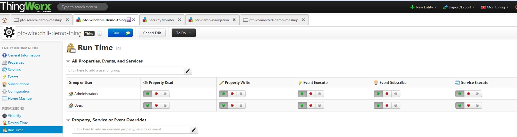

I have set the access for users and admin.

To use the sample mashup, you must enter the base URL in the configuration.
From the ThingWorx Composer, complete the following:
1. From the navigation panel on the left, select Things under MODELING.
2. Edit the ptc-windchill-demo-thing.
3. Select Configuration under ENTITY INFORMATION.
4. Set the baseURL value and click Save.
