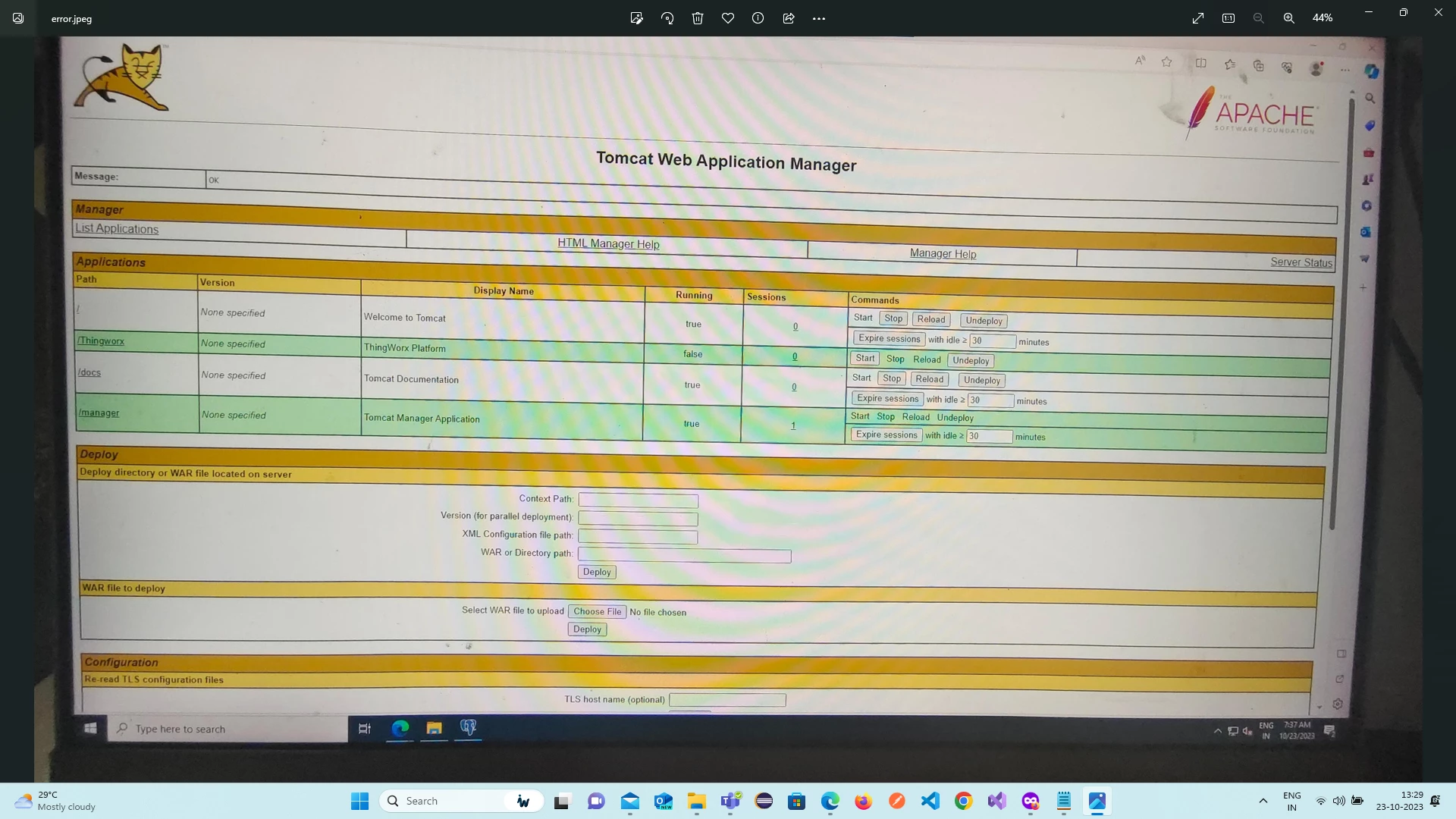

Unable to install ThingWorx 9.4
I've been trying to install Thingworx 9.4
Java - 11.0.21
Apache tomact - 10.1.15
Postgres 16.0-1
After deploying Thingworx.war in webapps, when I start the server, Thinworx is not starting. I get error message FAIL - Application at context path /Thingworx could not be started.
I've attached apache logs along with post.

Still this is not working
