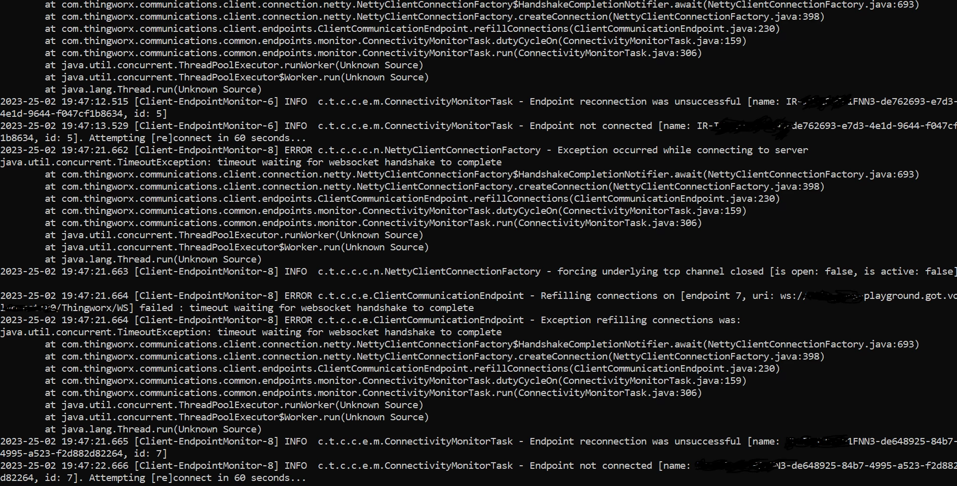

Unable to run Thingworx Integration Runtime:"Endpoint reconnection was unsuccessful."
I am trying to run Thingworx Integration Runtime but it is not able to connect to the Thingworx instance.
After running the below command from cmd:-
"java -DconfigFile=integrationRuntime-settings.json -jar integration-runtime-8.0.12-b1455.jar"
I can see the service trying to start but then at the end i get the message  "Endpoint not connected", which it attempts to reconnect but never connects.

Hi @pshashipreetham
If you can access ThingWorx Composer or Mashup, you should be able find the IP in the URL address.
replace the IP with localhost in the integrationRuntime-settings.json.
Make sure you can access/ping the IP address from the server where you are running Integration Runtime.
If your ThingWorx is running in HA cluster mode, you will need to install and run Connection server to route the websocket communication.
The Integration Connector uses WebSockets to communicate with ThingWorx. A typical HA landscape uses multiple Connection Servers with a load balancer in front of the Connection Servers. In an HA landscape, the Integration Runtime must route through the configured load balancer and to a Connection Server.

Hi @Vimal_Rawat
Could you please review the "integrationRuntime-settings.json" and make sure the ThingWorx appKey, host, and port is configured correctly? Also make sure the appKey is not expired in ThingWorx.
If still doesn't work, try setting "ignoreSSLErrors" to "true".
"Thingworx": {
    "appKey": "1234abcd-xxxx-yyyy-zzzz-5678efgh",
    "host": "localhost",
    "port": "8443",
    "basePath": "/Thingworx",
    "sslEnable": "true",
    "ignoreSSLErrors": "false"
Then open the cmd as Administrator to run the command to ensure you have permission to access the json file and execute the jar file

Hi @pshashipreetham
