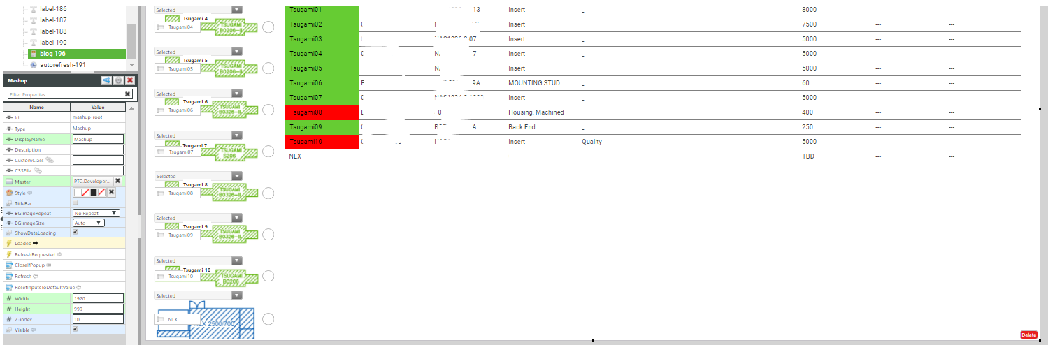

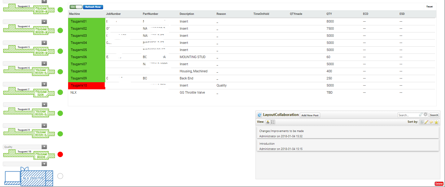

Below is where the blog should be, and where it does appear in the runtime and preview.

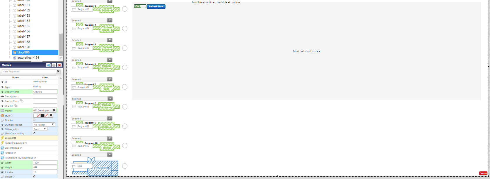

Below are both images of the New and Old composer. Blog-196 is selected, but it is stuck on what ever was previously selected (in this case, the Mashup) and it is simply invisible and will not allow itself to be selected.
