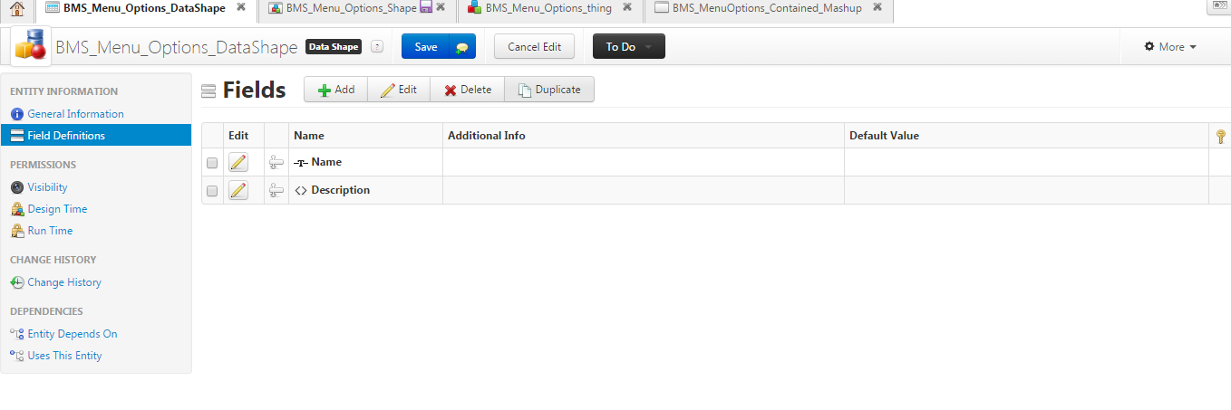

Dear Team,
I am unable to show html on list using infotable whose related datashape has html filed.
Service which put data in infotable
var params = {
    dataShapeName : "BMS_Menu_Options_DataShape",
    infoTableName : "BMS_Menu_Options_Info_tbl"
// CreateInfoTableFromDataShape(dataShapeName:STRING, infoTableName:STRING("")):INFOTABLE
var menuOptionInfoTbl = Resources['InfoTableFunctions'].CreateInfoTableFromDataShape(params);
var energy_status_icon = '<img src="/Thingworx/MediaEntities/BMS_Energy_Management_Icon">';
var data1 = new Object();
data1.Name = 'Energy_Management';
//data1.Description = "<span>"+'ENERGY MANAGEMENT'+ "</span> " + energy_status_icon;
data1.Description = 'ENERGY MANAGEMENT';
menuOptionInfoTbl.AddRow(data1);
var alarmAlert_status_icon = '<img src="/Thingworx/MediaEntities/BMS_Security_Solution">';
var data2 = new Object();
data2.Name = 'ALARMS_ALERTS';
//data2.Description = "<span>"+'ALARMS & ALERTS'+ "</span> " + alarmAlert_status_icon;
data2.Description = 'ALARMS & ALERTS';
menuOptionInfoTbl.AddRow(data2);
var crac_status_icon = '<img src="/Thingworx/MediaEntities/BMS_Automation_Icon">';
var data3 = new Object();
data3.Name = 'CRAC';
//data3.Description = "<span>"+'CRAC'+ "</span> " + crac_status_icon;
data3.Description = 'CRAC';
menuOptionInfoTbl.AddRow(data3);
var ups_status_icon = '<img src="/Thingworx/MediaEntities/BMS_Automation_Icon">';
var data4 = new Object();
data4.Name = 'UPS';
//data4.Description = "<span>"+'UPS'+ "</span> " + ups_status_icon;
data4.Description = 'UPS';
menuOptionInfoTbl.AddRow(data4);
var data5 = new Object();
data5.Name = 'FIRE_ALARMS';
data5.Description = 'FIRE ALARMS';
menuOptionInfoTbl.AddRow(data5);
var result = menuOptionInfoTbl;
view of datashape BMS_Menu_Options_DataShape.  Data shape has two field name and description in whicg description has html type
when I am rendering this infotable on list I am seeing like some   below : What is problems ??
