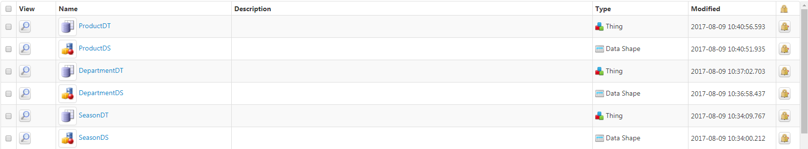

1. I create some Data Table to save the season, department and products

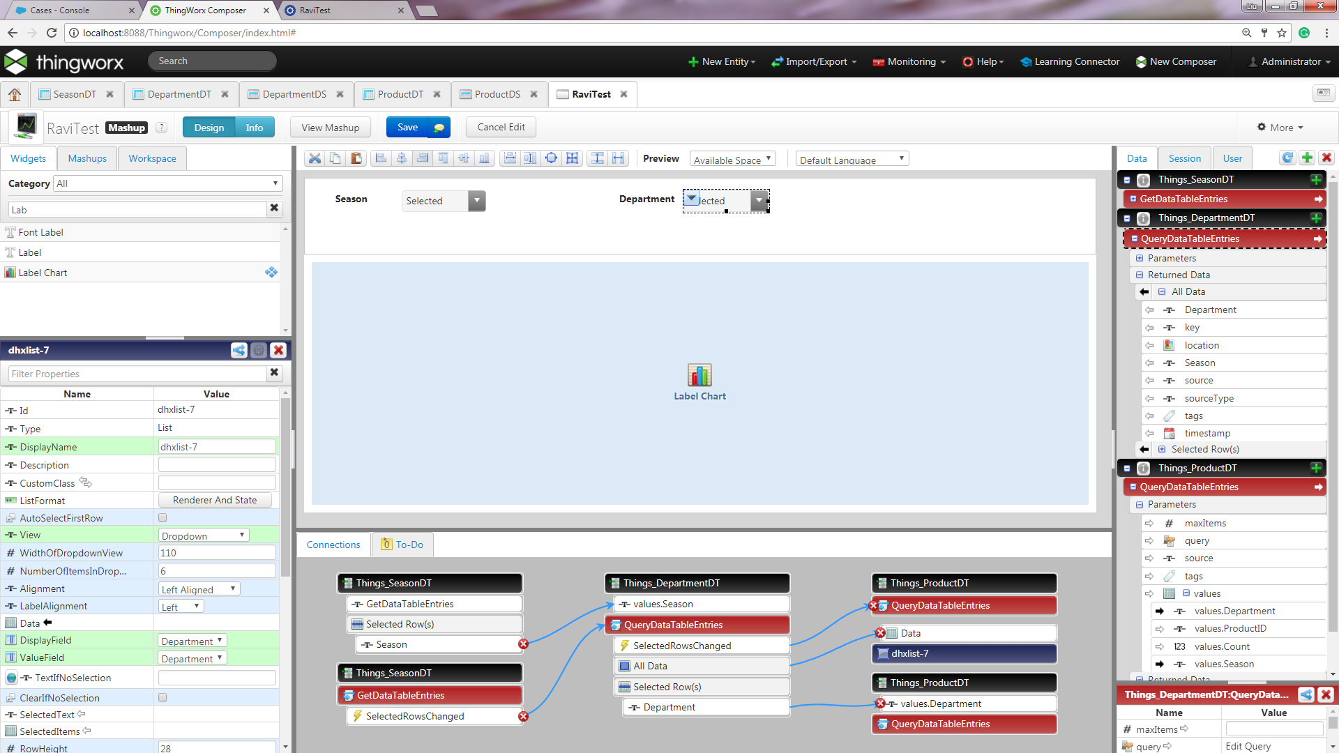

2. Create mashup as below: two list widgets and one label chart
Binding is very important:
1.set SeasonDT GetDataTableEntries mashup load event, and bind it to dropdown list
2.Bind SeasonDT -> GetDataTableEntries -> Selected Rows(s) -> Season to DepartmentDT -> QueryDataTableEntries  -> Parameters -> values -> values.Season
3. Bind SeasonDT -> GetDataTableEntries -> SelectedRowChanged to DepartmentDT -> QueryDataTableEntries
4. Bind SeasonDT -> GetDataTableEntries -> Selected Rows(s) -> Season to ProductDT -> QueryDataTableEntries -> Parameters -> values -> values.Season and bind DepartmentDT -> QueryDataTableEntries -> Selected Rows(s) -> Department to ProductDT -> QueryDataTableEntries  -> Parameters -> values -> values.Department
5. Bind DepartmentDT -> QueryDataTableEntries-> SelectedRowChanged to ProductDT -> QueryDataTableEntities.
6. Bind DepartmentDT to another list widget and ProductDT to Label chart widget.

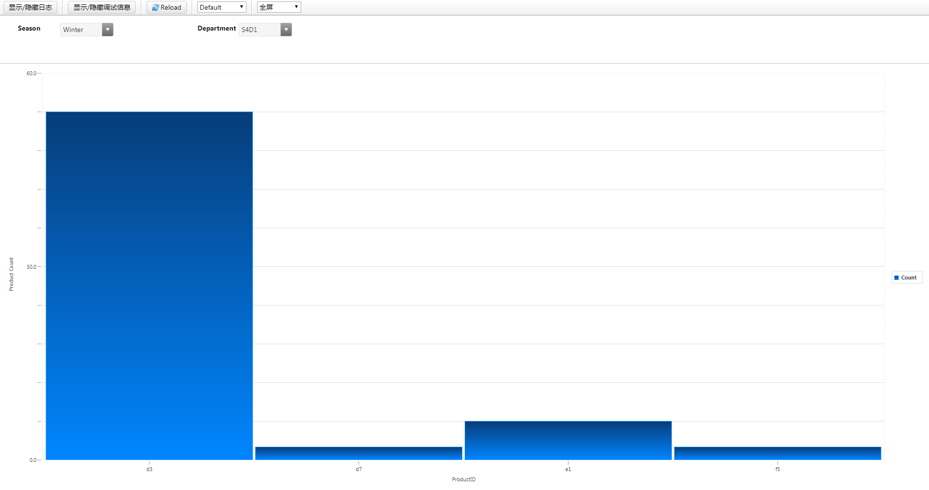

Output is something like below: After Department value is set, the label chart will query out specific records of product and count
