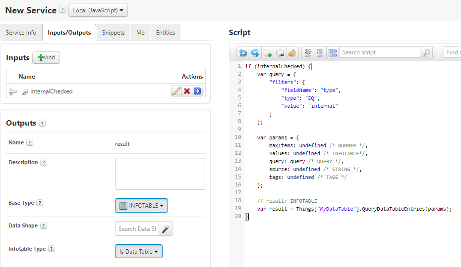

This is how your service might look (didn’t test):
For building the query, see the snippet Create query for DataTable.
