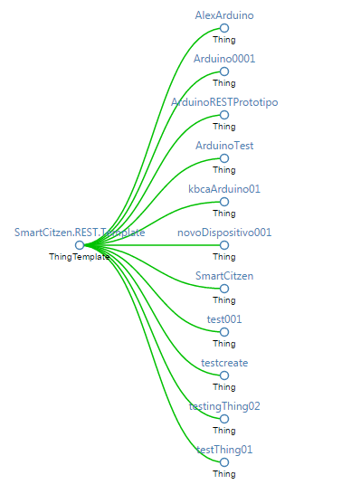

Hello All,
I am about to build an application that will connect information from different data sources and one cool functionality to add is the relationship tracking as it is done in TWX composer as it works with the Thing ->Thing Template  relationship (uses this entity screen).
The idea is that each node in the tree would drive the user to the system that owns the data.
Does anybody has some idea of what I should do to do it? Do i need to start from scratch or can I reuse something?
Cheers
ewerton
Best answer by Aanjan
Ewerton, I tried the D3 Tree widget, and that's the closest to the existing dependencies view -
State based formatting is available, so you can choose your Dependent Filed (to or from) and choose colors based on your preference.

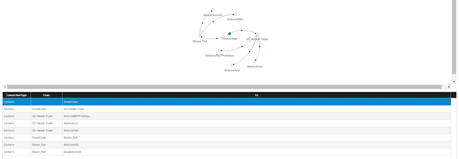

Partially answering my own question: it seems that the D3 Network widget should do the trick but I still did not get it to work properly.
I am testing it with a network and configuring it as shown below:
The result I got is this, which is technically not wrong, but it is weird.
Also, could I change the Link Color based on some state?
Cheers

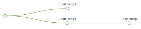

emoreira14-AlexandriteAuthor
September 9, 2016
Thanks.. can you send me the configuration you used? How are them different from what I posted?
