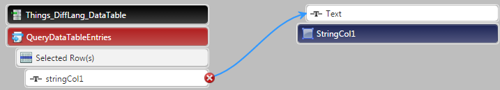

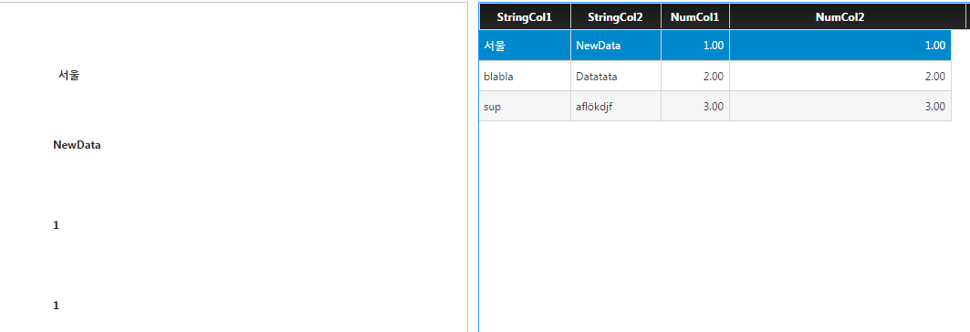

Hi Priyanshi, you could use the Selected Row(s) method of a service within the Mashup so that once you make a selection in a Grid  the data will be displayed or passed on to another entity be it a simple value display box or text input box within a form, see an e.g. below.
Note this will not "save" the selected data - this you will have to handle next by triggering a service to store that data to either an external database or a datatable

We tried binding a parameter of selected row to a textbox in a contained mashup but its not happening.

Could you share more detail on how you are binding the data? Is the Grid itself getting the data correctly? Here's a service flow from the e.g. i shared in my last post

I have displayed an infotable in a grid and then that selected row data should be displayed in form attributes.
