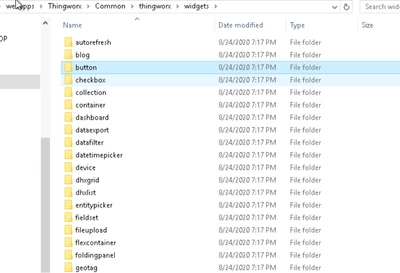

I need to see how the widgets are coded to use as example for custom widgets
I have found that on previous versions they were on TomcatRoot\webapps\Thingworx\Common\thingworx\widgets
But I can't find them on Thingworx 8.5
Right now I only need the Gauge and Button widgets
thanks
January 21, 2022
@MD_10146790
I checked on 8.5.7 instance and all the widgets are located at Tomcat\webapps\Thingworx\Common\thingworx\widgets location only
Please share the screenshot of your widgets directory.
Sachin Sharma
January 21, 2022
In those folders there are only images
Open for example the Button folder, you will only see a single folder called "images"
