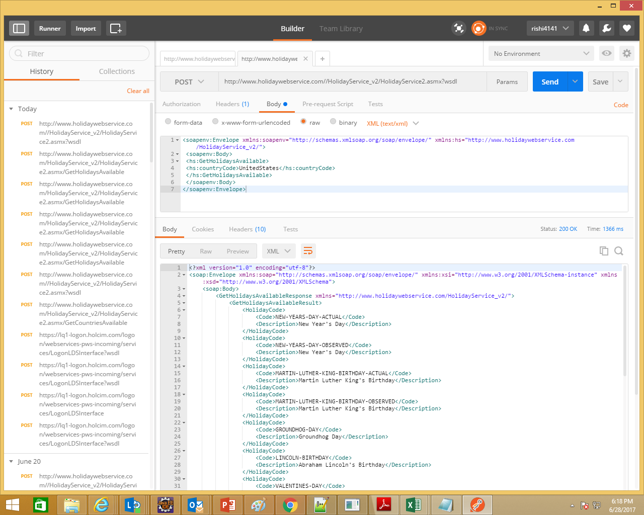

rsalunkhe1-VisitorAuthor
June 28, 2017
Here is my Postman reply.
