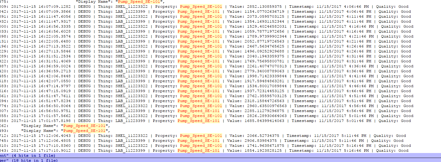

Dear Team,
Why value stream logging wrong time series?. As current time is 16:50:232 , but it logging 22:50:232
But real time is 16:46:46:000
Pump_Speed_SE-101timestamp
1741.9638671875
2017-11-15 22:46:46.000
2066.52734375
2017-11-15 22:41:46.000
2826.28930664063
2017-11-15 22:31:46.000
2960.63500976563
2017-11-15 22:26:46.000
2762.35595703125
2017-11-15 22:21:46.000
1534.80017089844
2017-11-15 22:16:46.000
1998.71423339844
2017-11-15 22:11:46.000
2261.40747070313
2017-11-15 22:06:46.000
2040.1943359375
2017-11-15 22:01:46.000

Hi Bhuwaneshwar, it would depend on what is writing/logging values to the ValueStream. If its an EDGE device then it'll pickup that time, this is what is written to the ValueStream.
You'll need to check the device/entity writing to this value stream.

Thanks Sushant.
Data is coming from edge connector and edge connector is pushing data in proper format.
bgupta-210-MarbleAuthor
November 15, 2017
Hi Sushant,
As from log data is push by edge connector as local time 4 to 6 hours. but in time series it is showing from 21 to 22 hours.
