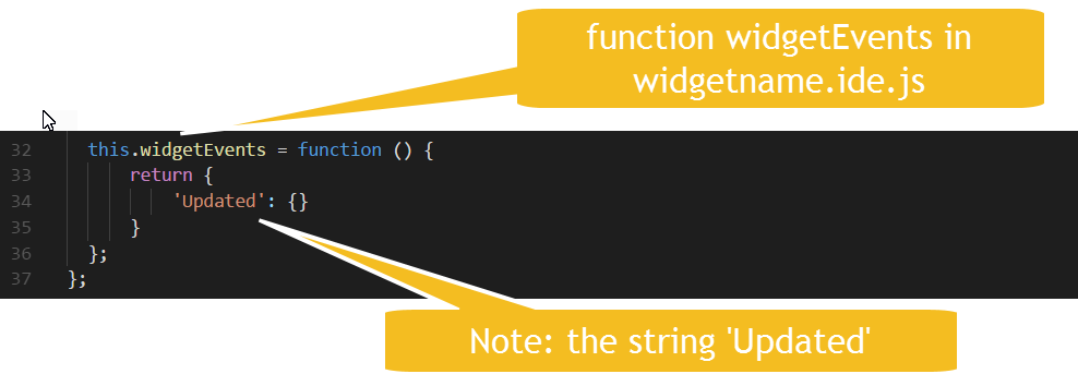

Previously we looked at renderHtml now we need to do introduce another function call widgetEvents in the ide.js and the  fireUpdatedEvent in the runtime.js files.

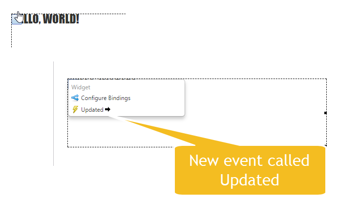

Below shows the implementation for the widgetEvents  function which basically adds the Updated event in the Composer
Composer view from the

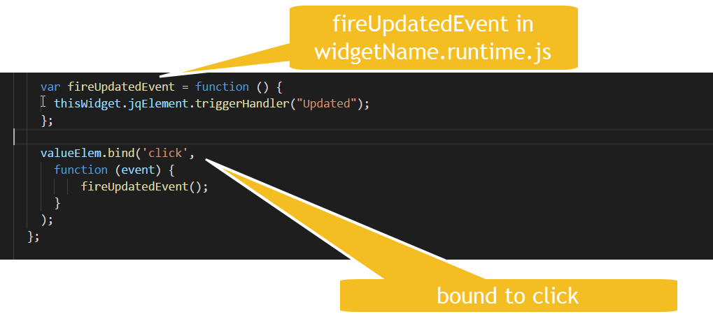

Next in the runtime we have to add a handler that handles the click event

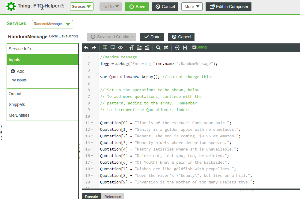

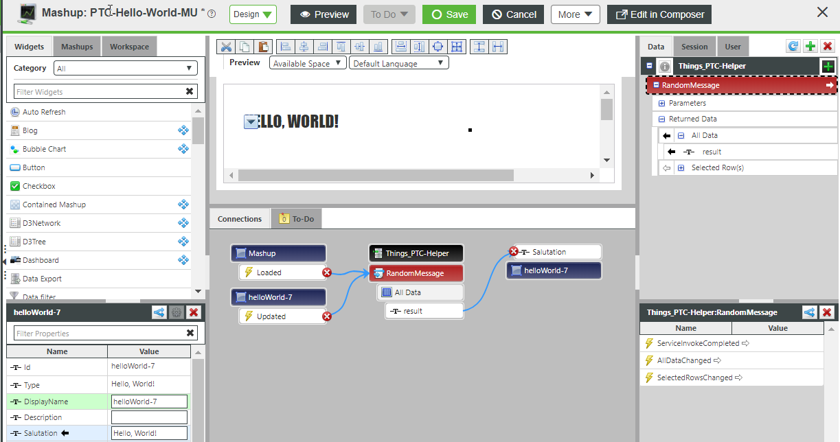

From there we can then wire up the click to a service called  RandomMessage which returns a random message from an array of messages
Below shows the service

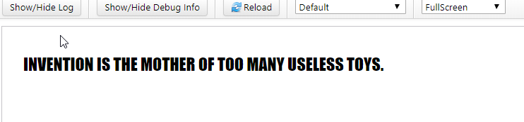

After clicking you get a random message (well not that random!)
