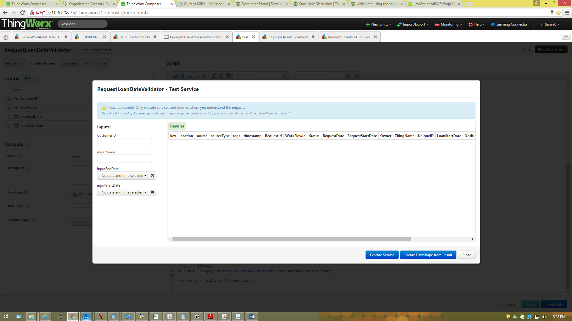

I'm working on a service which gets two dates as input(Start and End dates) and returns the entries for which the dates in a particular column lies within the input range as an infotable.
I have used a query with the "BETWEEN" type filter.
The code i used is:
var query = {
  "filters": {
    "fieldName": "LoanStartDate",
    "type": "BETWEEN",
    "from": 1483122600000,
    "to": 1517337000000
var params = {
  maxItems: undefined /* NUMBER */,
  values: ApprovedLoanableAssets /* INFOTABLE*/,
  query: query /* QUERY */,
  source: me.name /* STRING */,
  tags: "Keysight-Customer:"+CustomerID /* TAGS */
//result: INFOTABLE
var result = Things[CustomerID+"-LoanPoolAssetDetailDT"].QueryDataTableEntries(params);
The output is:
The output is without any entries.Yes, i have checked if there are no entries to be shown, but i'm sure that it consists of atleast one entry which coincides with the query. Can you point where i went wrong. Thanks in advance.

    You had filled a lot of parameters, you are 100% sure that the other parameters are ok? I mean:
    • values: ApprovedLoanableAssets --> Which it's the content of this object?
    • source: me.name --> You are sure the DataTable Entries has source filled
    • tags: "Keysight..." --> You are sure entries are correctly tagged?
    What I would do it's query for one condition ( source, or tags, or values ) and keep adding the others until you don't get anything.
    October 10, 2017
    Sorry for the late reply. The source parameter was wrong. Now its working fine. Thanks for ur suggestion.
