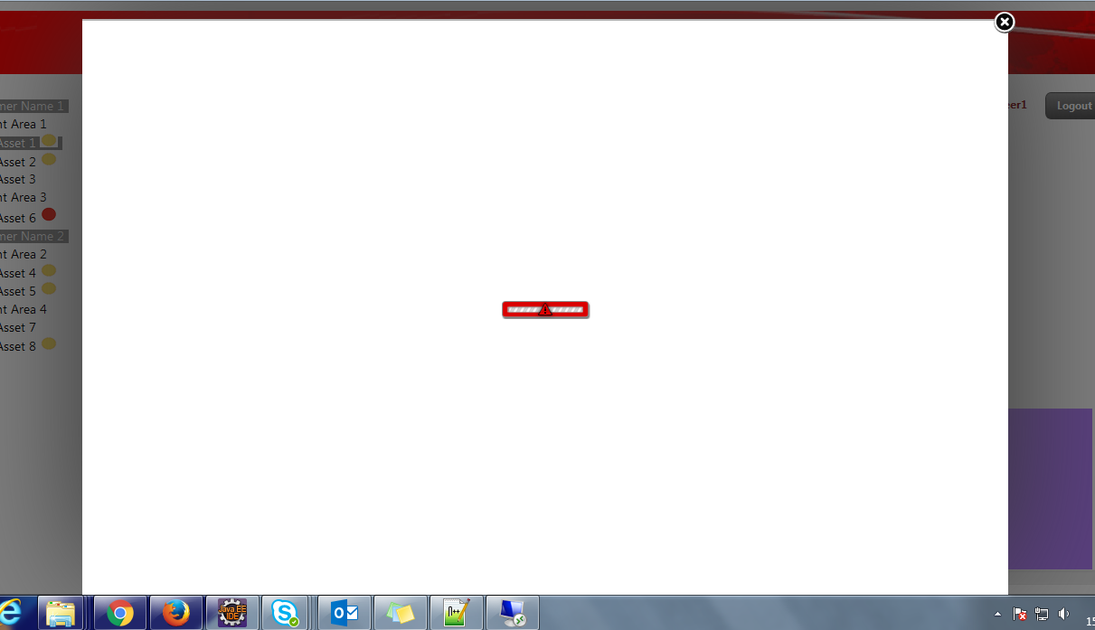

Dear Team,
I am getting below error when login as non administrator user.
Wrapped java.lang.RuntimeException: Entity [ContentLoaderFunctions] does not exist Cause: Entity [ContentLoaderFunctions] does not exist]
For administrator user no such error is showing.

    You will need Visibility permissions to the necessary resources.
    After that if it doesn't work assign the system user to have Runtime Service Execute permissions
    bgupta-210-MarbleAuthor
    June 16, 2017
    Thanks. It is working.
