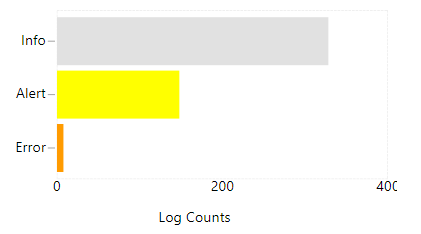

I've found that the X-Axis labels are often cut off on the right hand side of a Label Chart.  Is there a way to fix this to show the full value?  It should show 400 in the chart below.  I'm on version 7.2.5.-b56.

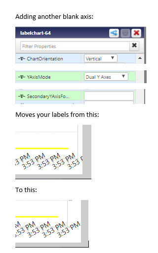

I found a quasi-solution for time series charts and label charts with a vertical chart orientation.  If you add a secondary Y axis and clear out the secondary Y axis formatting, you get some extra label space on the right.  It doesn't work with the horizontal label chart above but has fixed my other charts.
rflanagan1-VisitorAuthor
Aug 14, 2017 2:41 PM UTC
Adding a legend to the right hand side with a cleared format helps for horizontal label charts like above (assuming you don't need the legend!).

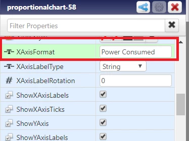

It can be rectified by adding the Longest X-Axis Label to X-Axis Format. It worked for me.
