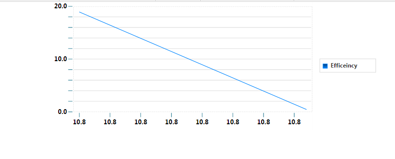

Dear Team,

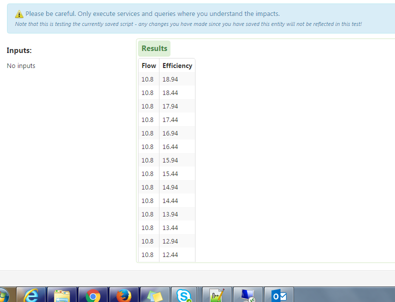

I need to draw below points on line chart.
But when I drawing chart on line. It's X axis  all points showing 10.8. What is problems?
Line chart

    Hi Bhuwaneshwar,
    I think that you are using Label chart widget. Label chart will regard X axis as string instead of number.
    Seem cannot display a line paralle with Y axis.
    But you can try with below link
    https://community.thingworx.com/thread/41446?&posno=2&q=XY%20chart%20line&source=search
    or draw an line that paralle with X axis by changing data of X axis and Y axis.
    Should you have any cocnern, please feel free to le me know.
