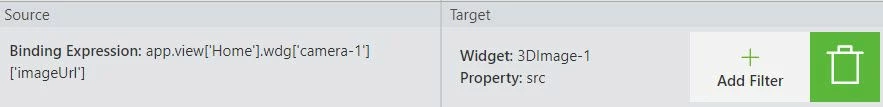

If you want to display the  taken picture in Studio you can use the imageUrl property  to assignee it to a respource of  image or 3D image widget.
With javascript code  e.g. :
$scope.setWidgetProp('3DImage-1', 'src', $scope.view.wdg['camera-1']['imageUrl']) ;
or via angular /studio  binding:
