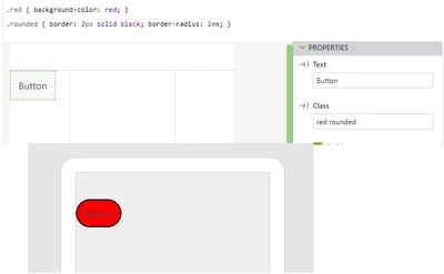

18-Opal
Nov 11, 2022 8:21 PM UTC
Yes, you can do exactly that, except use a space-delimited class list instead of commas. So the Class parameter should be "GENERAL green" to attach both the GENERAL class and the green class to this object.

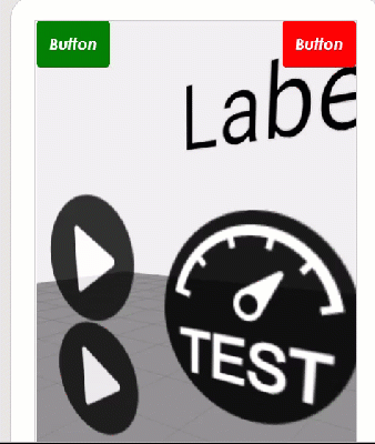

Nov 4, 2022 9:49 AM UTC
Hi @Pietro_Padovan ,
I think this should be possible if I correctly understood your requirements. Here is an example where when you click on element (here on 3DImage widgets) the js callback will change the style of the button. The style definition are loaded externally from upload folder in this example but it will be the same (no difference for the js code) if the styles are defined in the Application.scss tab. In this case the loading of the style def is not required
The setting is simple 2 function :
//$scope.cnslTxtIntl = val => console.log(val);
$scope.test=function() {
 //setting here the class properties of the buttons- definition in test.css
 $scope.setWidgetProp("button-1","class","button-2");
 $scope.setWidgetProp("button-2","class","button-1");
//set the style attributes for the 3DGauge - effect similar to class setting
 $scope.setWidgetProp("3DGauge-1","textattrs","fill:rgba(0, 0, 255, 1);textbaseline:top;textalign:left;font-size: 40px;stroke:green;colostroke-width: 3px;");
 $scope.setWidgetProp("3DGauge-1","font","Arial");
$scope.setWidgetProp("3DGauge-1","fontsize","30px");
 $scope.$applyAsync();
$scope.test1=function(my_string) {
 //setting here the class properties - definition in test.css
 $scope.setWidgetProp("button-1","class","button-1");
 $scope.setWidgetProp("button-2","class","button-2");
 $scope.setWidgetProp("3DGauge-1","textattrs","fill:rgba(255, 0, 0, 1);textbaseline:top;textalign:left;font-size: 40px;stroke:black;colostroke-width: 3px");
$scope.setWidgetProp("3DGauge-1","font","Courier");
$scope.setWidgetProp("3DGauge-1","fontsize","60px");
I attached also the project if you want to test it first. Please, let me know if this is helpful to achieve your goal or if you need further information.
