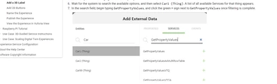

I am submitting a screen grab for reference. So I am not an experienced PTC user so I am trying to accomplish this Blue Pump tutorial, and I am not sure what this car1 does and if I can easily substitute it with created thing from instance.
May 4, 2023 3:07 PM UTC
Also, I forgot to mention: the car1 is not available on External Data anymore so I can't accomplish the Blue Pump sample tutorial - 1: I have to learn how to substitute it; 2: I can wait when it PTC will place it back, but there is no estimated time.
