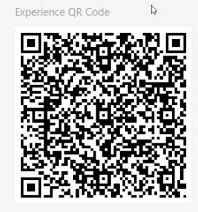

As metioned I tested the project from the  post)    - I simple converted it to HoloLens project and tested it on the HoloLens 2.0 device with the current version of OS and Vuforia View - and it was working so far.
You can test the behavior QR code
or the link: https://view.vuforia.com/command/view-experience?url=http%3A%2F%2Fpp-2005051423cb.portal.ptc.io%3A8080%2FExperienceService%2Fcontent%2Fprojects%2Fmodelmetadatahololenstest%2Findex.html%3FexpId%3D1
start the project and tap on any component - what is the effect?
