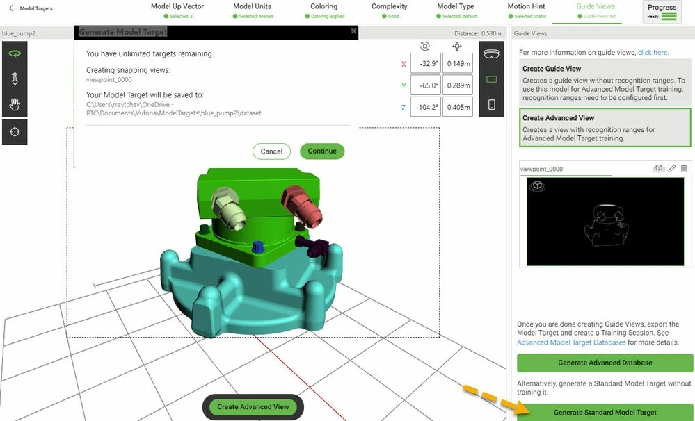

  2.1) the first point is how to generate the model Target.  We can use the Model Target Generator tool to generate Model Targets . The model Targets are then saved as <modeltargetName>.dat and   <modeltargetName>.xml files . We can save these targets in a subfolder of the Upload project folder and try to used them later in the project. I tested with Standard guided views.

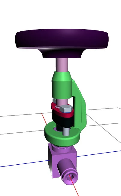

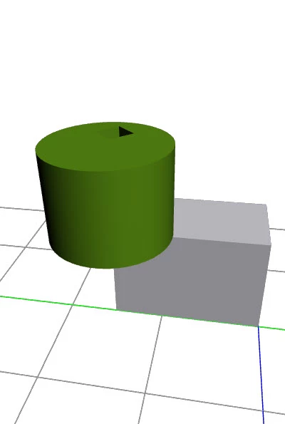

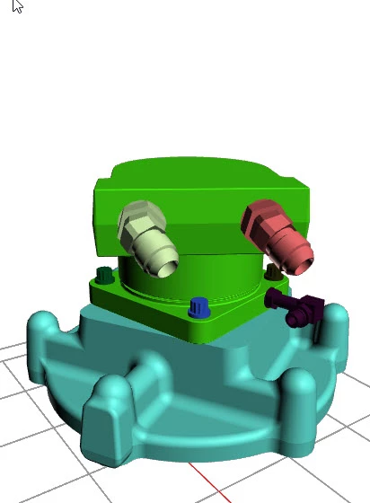

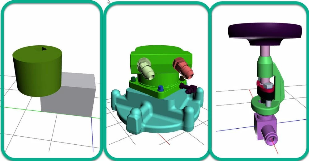

To test the issue I create an simple project with the following 3 Targets generated by the Model Target Generator

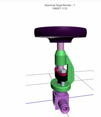

after we enter the view - the target will start detection for the current item (here the 0 INDEX of the array. Then follow an call of the next target
$scope.$on('$ionicView.afterEnter', function() {
 $scope.timeoutCallRef =$timeout($scope.changeTheSearch,5500);
Means the call is with some delay 5.5 secs here. This is the time for the search of the current Model Target. If we want to stop the search we can call some code like this:
$scope.stop= ()=>{
 //reset the timer
 if($scope.timeoutCallRef != undefined) {
 $timeout.cancel($scope.timeoutCallRef);
 $scope.timeoutCallRef = undefined;
The call of the next MT is simple navigate to a second view e.g. search -> increment the MT Item - Then display in the search view the new target /e.g. info or picture. This is then the  new target which should be searched when it returns to the home.js view.
Because I do not have the real object - I used for scanning - simple the jpg's of the targets. There was no problem to detect the targets. When a target was detected then the search is stopped and the corresponding model /pvz file was displayed. This is occurs in the trackingacquired event listener:
