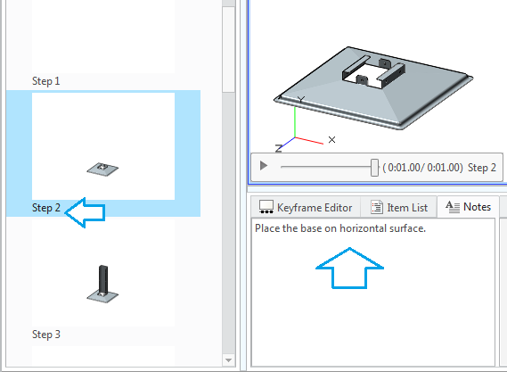

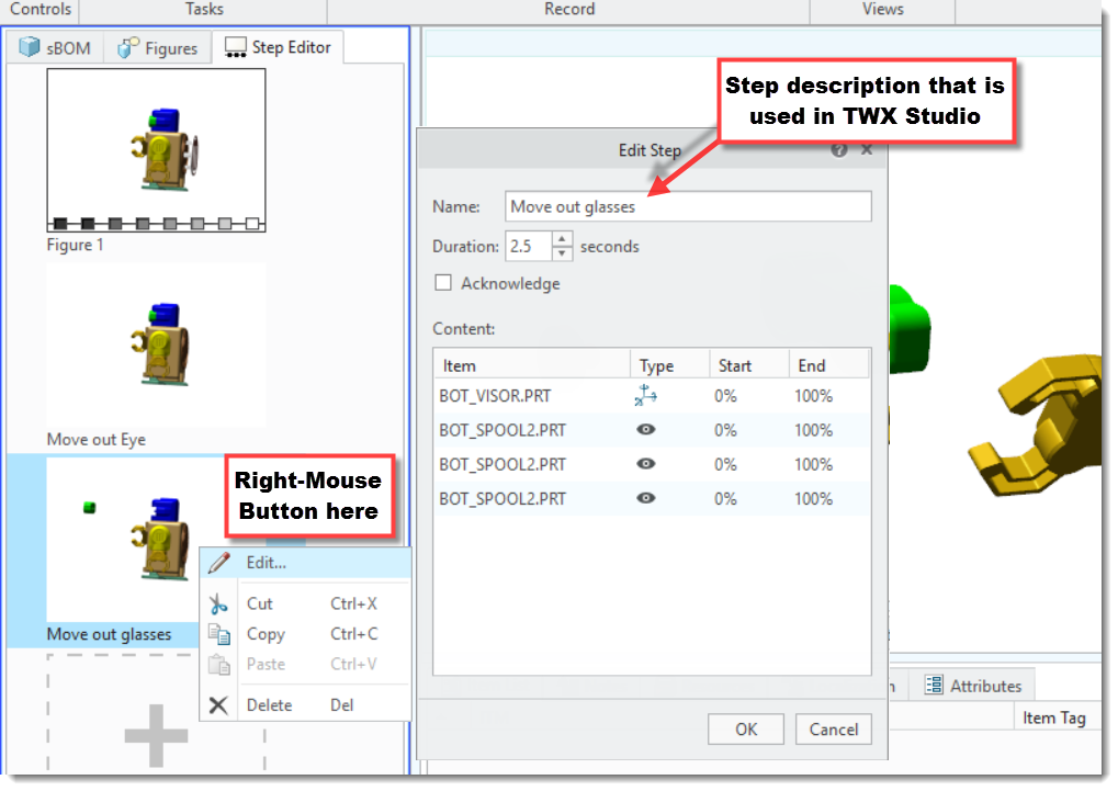

To setup the scene: Here is what I meant with Step names that you used in Creo Illustrate:

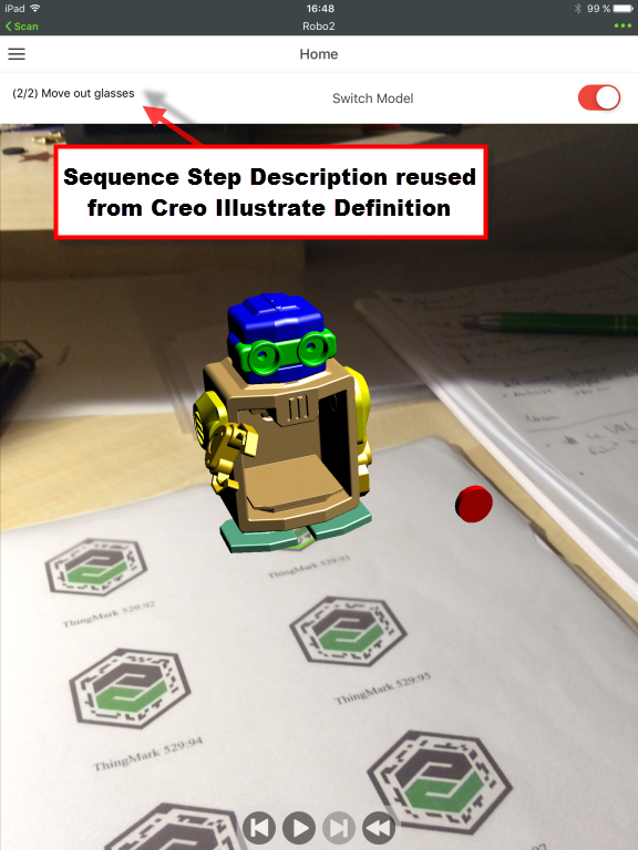

Now in Thingworx Studio you want to have the following result:
The text is rendered with a simple Label widget. You'll have to remember the ID of this widget for the following javascript tweak. Add the following text to the Javascript section of your View:
var labelId = "label-1"; // ID of the Label widget that displays the Step progress and description  text
// this $on event handler switches the label based on the the sequence definition
// the arg variable is of the following form: (<step #>/<total step #) <step name>
$scope.$on('newStep', function(evt, arg) {
  $scope.setWidgetProp( labelId, "text", arg); // get the currentStep from the arg
Now you only need to provide the correct initial value in the Label widget text property and add control widgets (Buttons, Playback) to drive your animation and you're done.

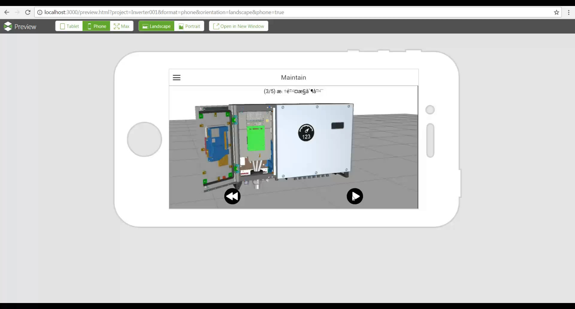

Thank you  Moritz von Hasselbach. The code works .
But  when Creo Illustrate step names inclsude Chinese character,In ThingWorx Studio preview, Chinese characters can not be displayed properly.

As per the previous two comments, I'd also like to know if there is a way to extract out the step description.  If I follow your example, the label shows (<step #>/<total step #) <step name>:
As Thomas showed in his previous post, in Creo Illustrate, you would type in detailed information in the notes tab which in the PVI file is stored as step_decription.
If found that in the sequence.js file in the project folder, the function SequenceStep(step) gets the following properties:
  • step_name
  • step_duration
  • step_acknowledge
  • step_description
And in the vuforia-angluar.js file, there's the definition of the newStepEventArgument that is set to (current step / total steps) step name.
So the question is, how to we extract out the information like step_description into the label text?
Many thanks,
Allan

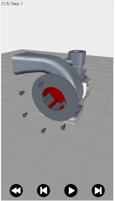

Hi Moritz,
Good day!
I would like to know, how to display only "step name" in my vuforia studio?
Currently it is showing like this "1/11 Step name". But what I want is only "Step name" to be seen.
Thank you!

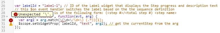

Jul 25, 2018 12:00 PM UTC
You can cut of the first part e.g. '( 1/11)  ' with a regexp  so that you end up with just the title.
The code snippet would look like this:
 var arg2 = arg.match(\(\d+\/\d+\) (.*))[1];
 $scope.setWidgetProp( labelId, "text", arg2); // get the currentStep from the arg
Jul 30, 2018 10:36 AM UTC
Hmm... It gives me an error.
