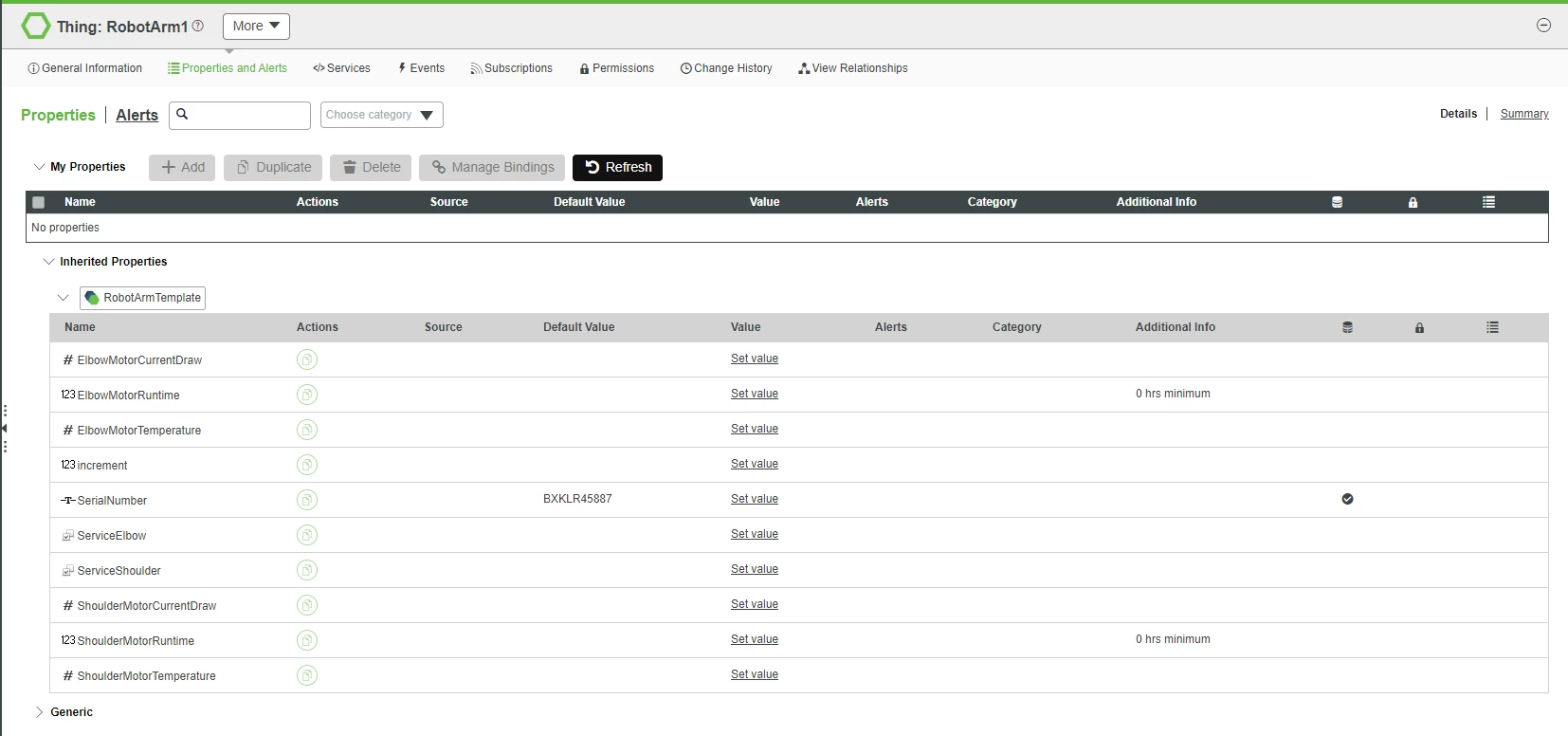

Hello  @ytella ,
How can i please check in Thingworx if the datas are refreshing ?! (Should i install some Simulator program?!)
I tried refreshing the properties of the entities in Thingworx Composer but nothing is changing (Screenshot)
I also tried searching for "RobotArmSimulator" in the ThingWorx Comoser but i don't find it.

Jun 29, 2020 8:33 PM UTC
@Ahmed94 Could you please share the RobertArm Entities from ThingWorx. Also, I highly appreciate it if you could share the Studio project with me to track the issue
