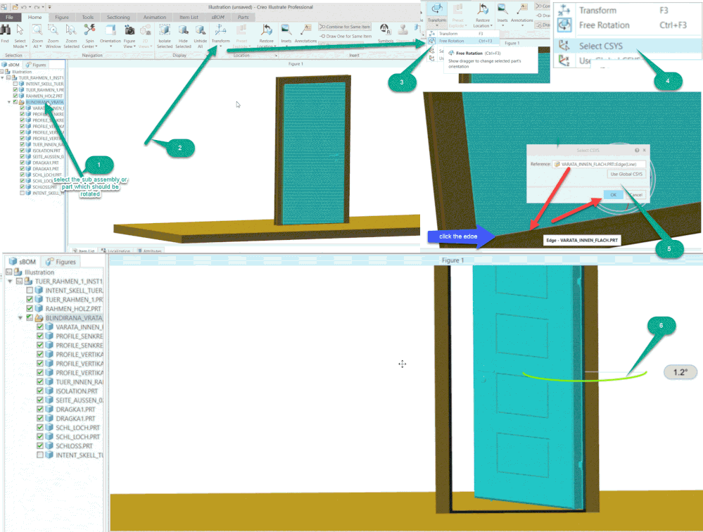

Mar 20, 2019 10:42 AM UTC
Hi @bobweb,
so tryed in the following picture to explain how to rotate to an edge axis a part or subassembly (here in the example is subassembly):
1.) You have to define a figure and set it as current. Now you can select the object what you need to rotate
2.) Menu transform
3.) select free rotation
4.)menu point "Select CSYS"
5.)select e.g. edge which you want to use as hinge
6.) rotate the object in the step
so hope this will make it clear. If not then let me know!
