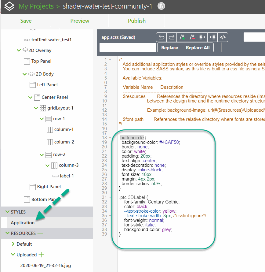

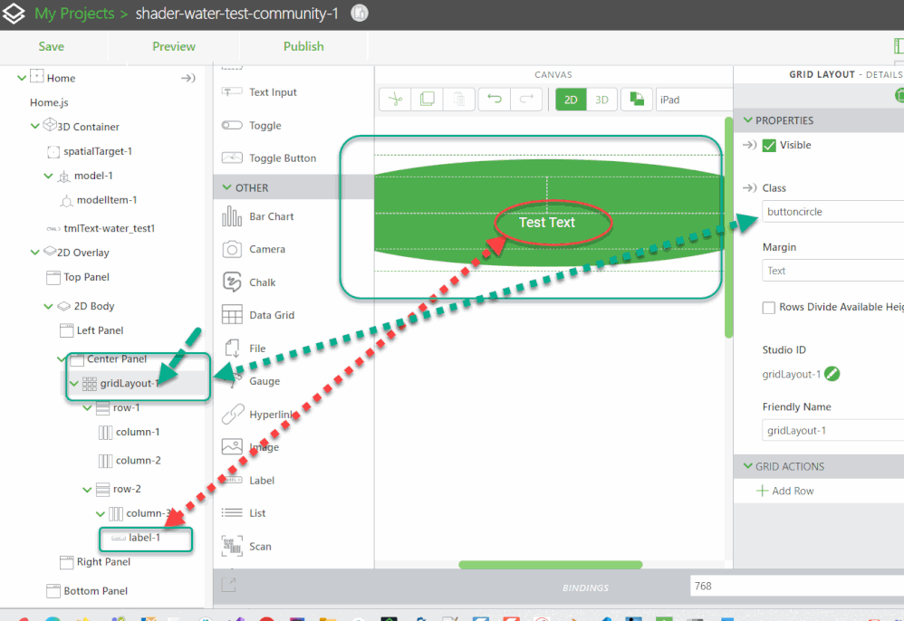

Hi @Rocky_2021 ,
when you meant grid row text - for which  widget you want to apply the font.
So styles are defined in app.scss and they could be set to the class properties - exampe:
so example of style definition as text :
.buttoncircle {
 background-color: #4CAF50;
 border: none;
 color: white;
 padding: 20px;
 text-align: center;
 text-decoration: none;
 display: inline-block;
 font-size: 16px;
 margin: 4px 2px;
 border-radius: 50%;
.ptc-3DLabel {
 	font-family: Century Gothic;
 	color: black;
 	--text-stroke-color: yellow;
 	--text-stroke-width: 3px; /*csslint ignore*/
 	font-weight: normal;
 	font-style: italic;
 	background-color: grey;

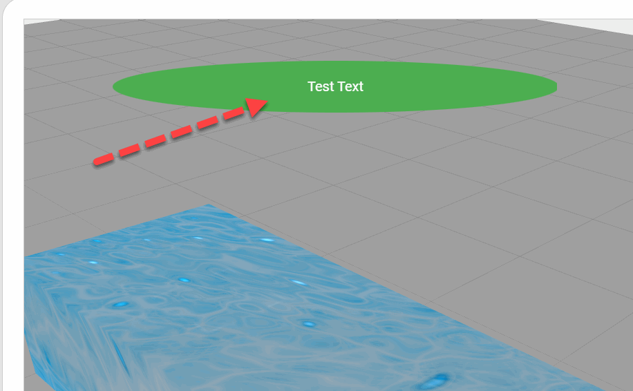

and then as class set to a class property e.g. here of the gridLayout widget:
add e.g. an label widget and test in preview:
I did not tested on mobile but it should work if not then please, let me know.
So according to the font - if it is some new created you need to check if generally it work on desktop on the mobile . I never used non standard font. But possibly you need to add it to a project folder and then refer to it via style variable
$font-path References the relative directory where fonts are stored.

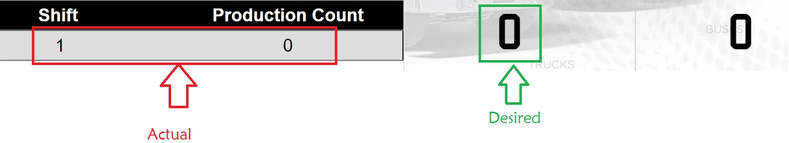

Thank you @RolandRaytchev for the quick reply.
In Thingworx composer I am using GridAdvanced widget.
in the screenshot below,
Left side is Grid-Advanced widget, & Right side Zeros(0) are label widgets.
I need the font of GridAdvaced Text ( 1       0 ) to be the same as label font.
For label I am using following css.
Please try it for grid advanced widget in thingworx, and let me know if anything works for it.
