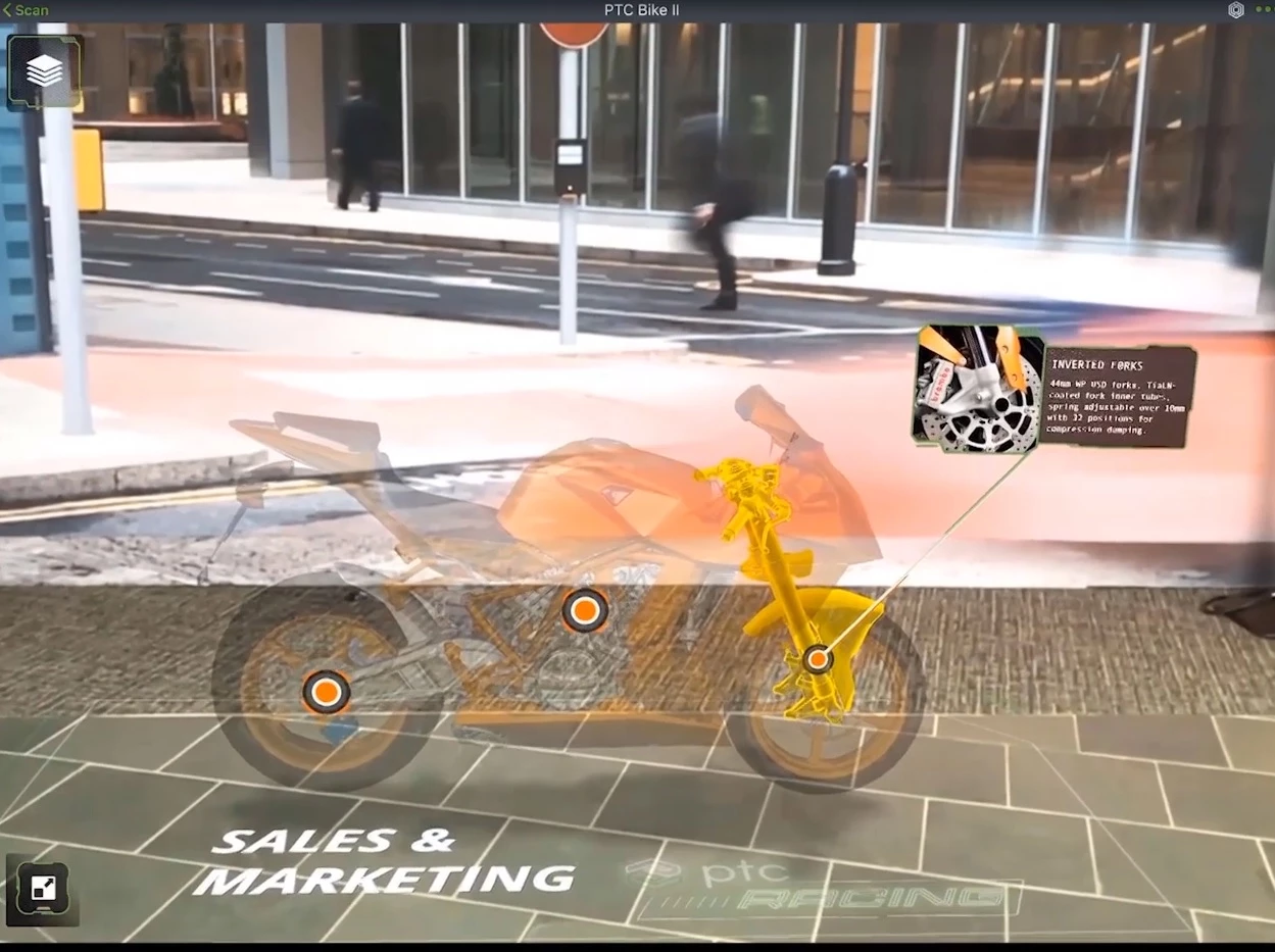

How to highlight the part when selecting it from screen and pop an 3D image ?
I have seen ktm bike experience i want to create same type of experience in which i want to highlighted the part once you touch the button on the screen and display 3d image and also it highlight the information of the component.
Let me know if any one tried or having such solution.
Thank you

Thank you for your reply you have given too many information but my query is simple i want to flash the component once it's in view app and it should display the 3D label or image.That's it.
Can you share some simplify procedure or video to do the same.
Thank you

1.) part 1.)  how to flash a component - so believe you mean something like to change the color  e.g -> origin color -> red after delay 0.3 -> green ->0.3 delay-> red ..... some times… and then back to the original color.... ? right?
This is possible. But to provide an example I need to know what component is it?  Is there possible to create  a modelitem widget for it . This will make it very simple. If this is not possible , then what info do you have for this component. Because we need the information at least to which model widget it belongs and what is the occurrence path /component path of it some thing like /0/1/9. In this case we can flash it with javaScript and I could write an simple example which will demonstrate this
2.) part 2 -> it should display the 3D Label or Image. What this means? Could you provide an example /description.
So it is possible :  we defined some 3dlabel Widget and make them invisible and later set the visibility to true and set the text to particular value…. Potentially we can also move it near to particular component…. Etc.
The same is possible to 3d Image with the difference that we can not change a text here but we can change here the resource image
