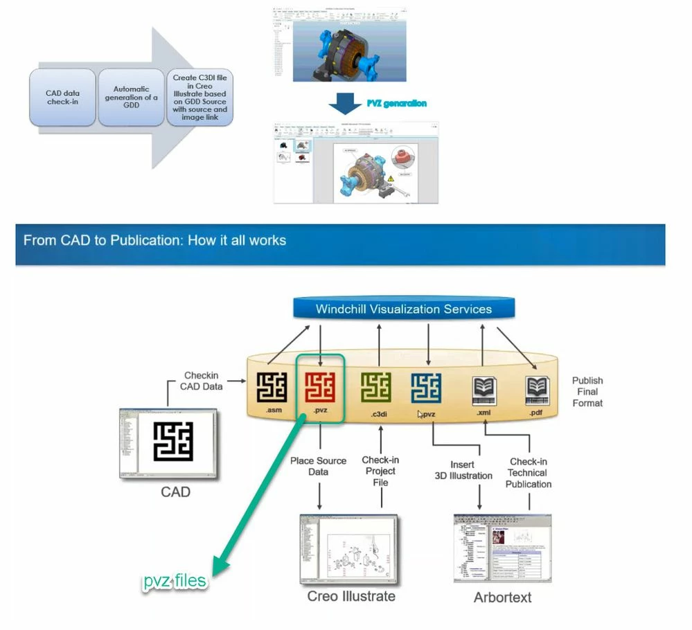

for the Integration  from  windchill to TWX - so the step is to export first from Windchill the  pvz files as export to folder  - as the part what is visualization /Windchill adapter could be seen in the article   https://www.ptc.com/en/support/article/CS112832
  1. In Windchill, if GDD is enabled, export pvz file generated by Creo View Adapters.
