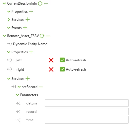

I started working with EXTERNAL DATA and I would like to know some JavaScript syntaxes:
  • How to get EXTERNAL DATA Parameter value from javascript?
  • How to run EXTERNAL DATA Service from javascript?
  • How to get EXTERNAL DATA Event value from javascript?

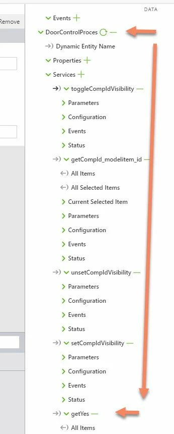

First the most easy way is  to get  data of an service without parameters:
 So to get external data from a service which is working on the thingworx side
var getYes=$scope.app.mdl['DoorControlProces'].svc['getYes'].data;

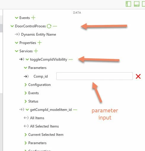

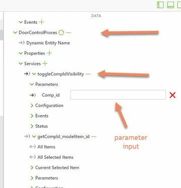

To call an external service which requires parameter. In this case I used some constuct like this :
$scope.toggleCompIdVisibility = function(Comp_id) {
 console.warn("toggleCompIdVisibility Comp_id="+Comp_id);
 var prop = "Comp_id";
 var message = Comp_id;
 $scope.$applyAsync(function() {
 $rootScope.$broadcast('app.mdl.DoorControlProces.svc.toggleCompIdVisibility',
 "property": "Comp_id", //parameter name
 "message" : message} //parameter value
 },500 ); //some delay
So giving the inputs as json object

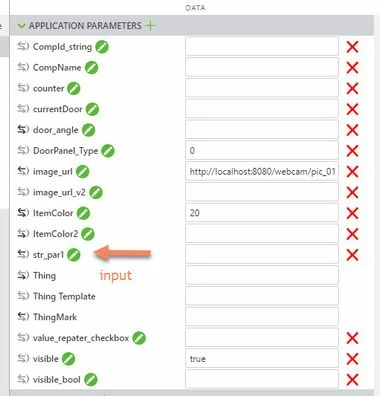

But there is also another approach - to call the sevice and bind the input parameters to an application parameters. So in this case before calling the external service you can set the application parameter.  In this case it should looks like:
 $scope.app.params['str_par1']= Comp_id;
 $rootScope.$broadcast('app.mdl.DoorControlProces.svc.toggleCompIdVisibility');
 },500 );
In this case the service is called without to use input parameters. Here I set an application parameter str_par1 to the component value
So this means that we set applicaiton paramters which have binding to the service input parameters
The more easy way is to try to call all services if possible using  direct binding. So means if you have a button then you can bind the button click event to the service e.g. "toggleCompIdVisibility " and the service input paramets has binding to the application parameter "str_par1".

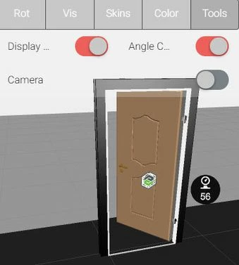

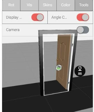

The sample code should check a value comming from thingworx. The value of an angle - it should be set to rotate the door angle assembly (here as modelitem).
The  watch is checking the  door_angle applicaiton parameter . When the value of this parameter will change then it call the code to set the rotation angle of the 3d model assembly
$scope.app.params['door_angle'];
 Otherwise the door_angle parameter has a binding to the  the DoorAngle property of the DoorControlThing-1
So here is the effect that the door assembly follow the chagne of the thingworx entity

I am looking for syntax which enable me to set input parameter of a service (from External data - for example maxItems property from QueryPropertyHistory) directly from javascript code.
I hope this is more understandable (I'm not so skilled in English Smiley Happy).
Tomas

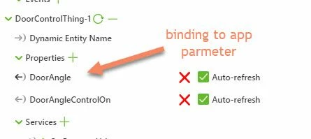

So I hope here  my attempt to do some contrubution to your questions:
 },500 );
