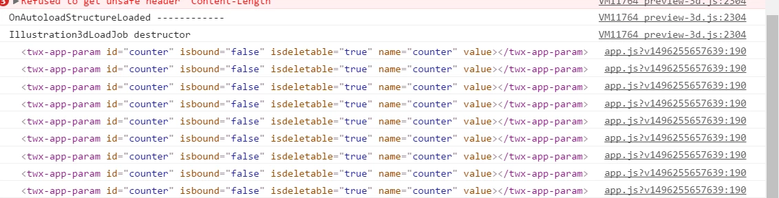

I am attempting to use a simple JS timer function to write values to a variable, which is then bound to the model property "ry"
The idea being, I can click a button to call the function, the the model continuously rotates until the function is cleared.
I created the "counter" parameter and bound it to the "ry" property, as well as defining the click events as their respective functions.
However, the dev console shows that the value is not being stored in "counter" and is not showing as bound to "ry."
My code looks like the below:
$scope.set_timer = function(){
  $scope.app.params['counter'] = 0 ;
  $scope.app.params.time=setInterval(function(){
    $scope.app.params['counter'] ++;
    console.log(counter);
  , 1000);
$scope.stop_time = function(){
  $scope.app.params.time = clearInterval(time);
Any help is greatly appreciated.

Updates:
The function does appear to write to the ry property, but only if I click the model. Any idea why I would have to click to initiate the property update?
Additionally, the values of "counter' still do not appear to be stored in the console, despite clearly being updated. Any thoughts on why that might be?

Jun 7, 2017 6:24 PM UTC
I call the function on a button event.
However, the model doesn't actually update via the parameter unless it is clicked on. i.e. the function is writing the parameter bound to ry, but the model doesn't change to represent those updates unless clicked on.
