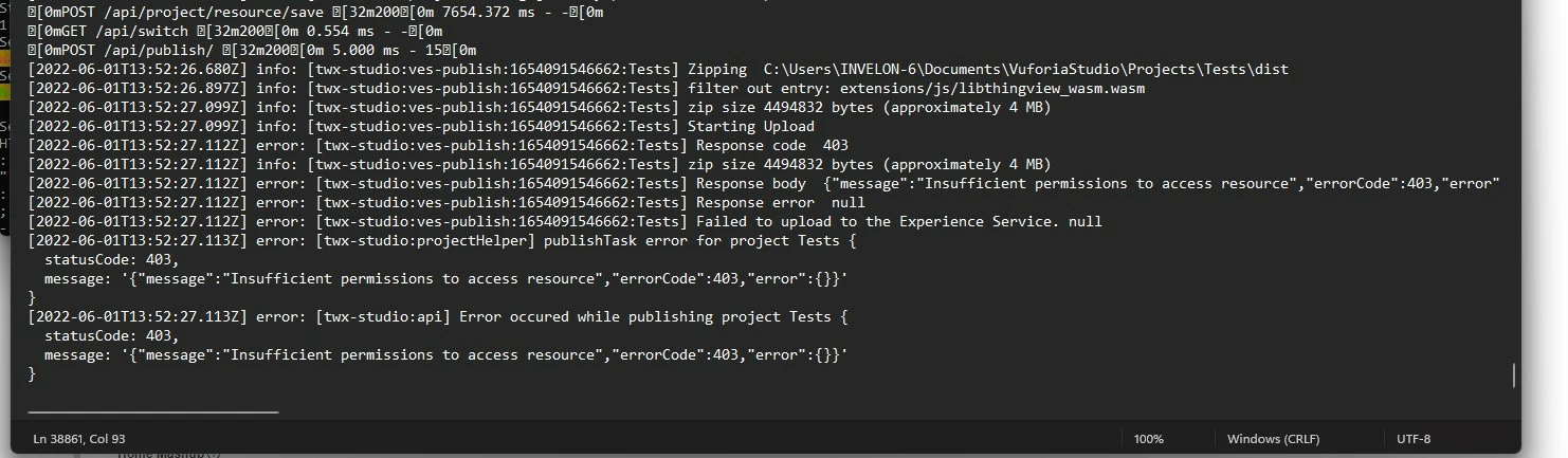

Local experience service fails to publish
I have everything setted up and logged as Administrator, but when i publish, I'm recieving 403. Where i should update this privileges??
